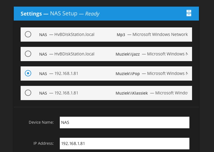

« Reply #2207 on: 18 Aug 2017, 07:21 pm »
This is so cool, the alphabet menu is perfect now! magical. In this implementation, it is a joy to work with, and indeed an enhancement to browsing the folder as it is. Thanks!
Something else you might be able to fix:
In the NAs setup page all available drives are displayed. If one wants to edit a drive, a click and select the edit box suffices. But then if you want to edit another drive, the selected specifics of the first drive are still in view, and don't change by selecting the other drive. Could you make this 'hot', that is to say, clicking the other drive, changes and shows that selected drive's specifics?

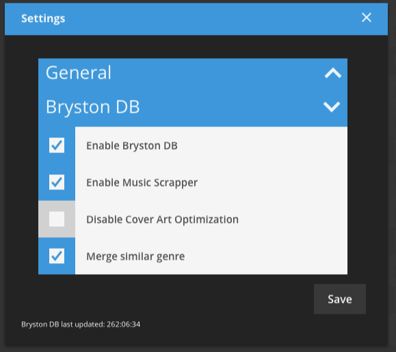

FYI ... I cannot stop Manic Moose from merging similar genres, even though I uncheck the box and click on SAVE. It keeps reenabling the checkbox on its own.
S2.35 2017-08-25
Build: Manic Moose
MPD: 0.19.21 NEWS
Kernel: 3.16-0.bpo.2-486
COPYRIGHT BRYSTON LTD. 2010
unincognito
S2.35 2017-08-25
Build: Manic Moose
MPD: 0.19.21 NEWS
Have you checked the read/write state, filesystem or free space for the user partition in disk information?
I assume you mean /dev/sda1? It's usage is at 23% and /mnt/img (which I believe is the user partition?) is rw for the bryston user.
This new behavior started with the latest BETA release, as described in my original post.
Thanks.
EDIT: For what it's worth, I was able to enable the "Music Scrapper" and the setting does persist. By the way, I think you mean "Scraper". Oh, and your accordion panel arrows in the new settings box are backwards: the arrow should show the action of clicked, not the current state.
