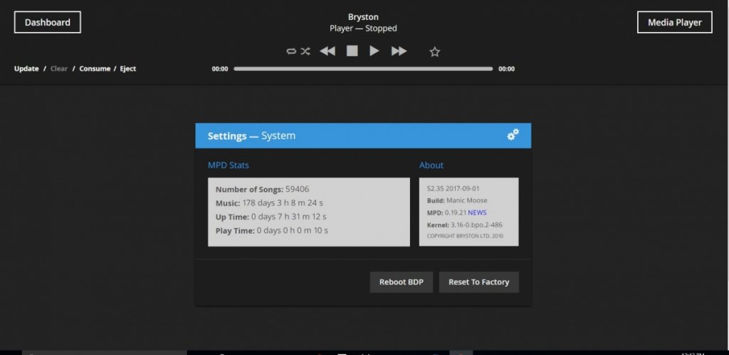

Hi Chris
Noticed on updating to
S2.35 2017-09-01
Build: Manic Moose
MPD: 0.19.21 NEWS
Kernel: 3.16-0.bpo.2-486
BDP-2
I am getting a "Bryston bb disk full error" and asking me to create a scratch disk
Have done a couple of reboots and tried the update again.
Player works OK
Regards

Rebooting or redoing the update likely isn't going to make it go away, either there is a bug with the new code or your userspace is full or nearly full.  You can either place the bdp into service mode for us to check or go into media player settings.

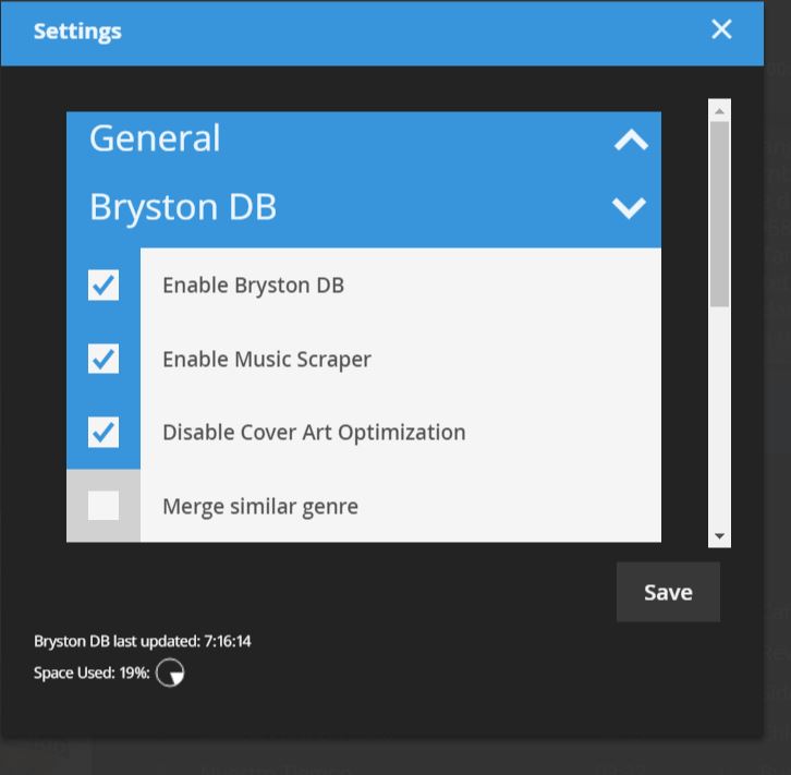

I have 60,000 songs in my attached music on my BDP-3 and looks like I am only using 19% of the user-space.

It is in fact full, you'll  notice difficulties scraping new data, adding new music (library won't update properly) and or rebuilding the database.  You may want to just clear the cache media player, we made some changes to scrape less data related to missing albums.  Or just set a scratch drive

Cleared cache and reset db -- everything OK

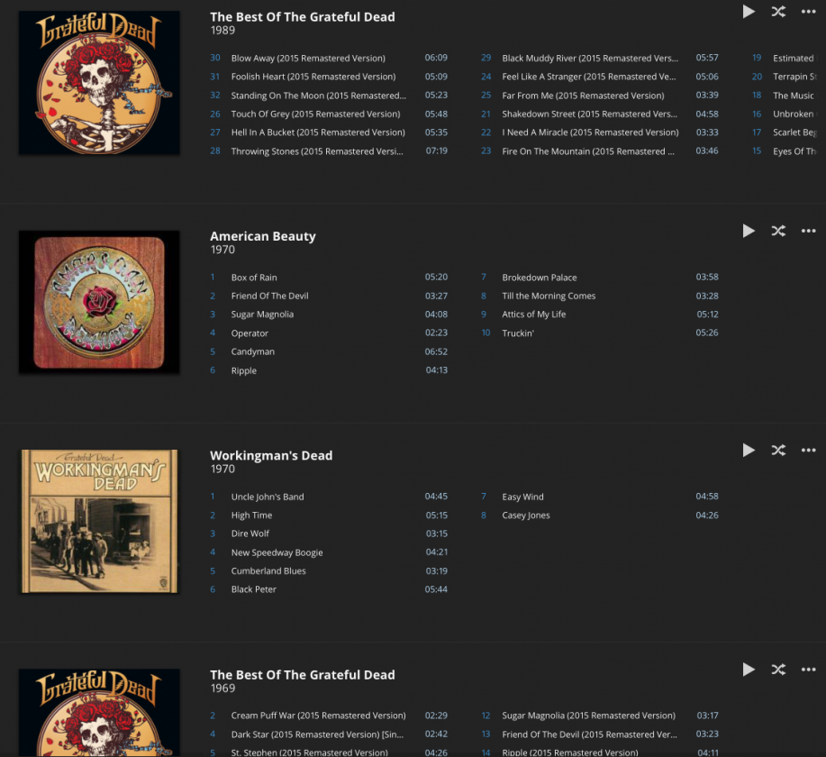

Default sorting in Artists View.
In general, I like the option of seeing albums within a selected artists sorted by year, but I have a lot of albums that are compilations. As such, the individual songs are date tagged with the release year for that song.
See the attached image. I have a number of albums that display like this, with track indexes sorted by date and albums broken apart within the artist view.
I think you may want to consider an option to sort by album name or release year.
