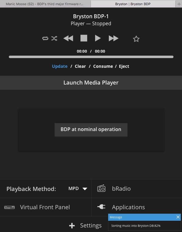

Been experimenting with the Artist view for a bit now. Is it correct only a playing song title is displayed, and no playlists and coverart view  are shown in this view? Having grown accustomed to being able to see whats up next and being able to watch the (all) coverart really makes me miss the playlist of the default view.
Is there a way you (we) can add that to the Artist view please?
clicking a song makes it directly available in the info screen and plays it. Selecting anything else while playing immediately shows the updated playlist message, stops the current song and plays the clicked one. Instead of adding it to a playlist and let me push next. Can we control that behavior in settings please (much like Mpad offers you several options while selecting tracks)?
I've found out that it is saver to update between smaller editing Tags sessions, than to wait for all tag edits and save in 1 big change. Tags more often than not don't stick while doing the latter.
MM is programmed for automatic Bryston DB rebuilds after each update. Which is very nice when doing 1 big session, but not so very cool when eg editing per album, and doing so for a longer period of time, updating (saving the edited tags) frequently. It is very heavy on the BDP (especially my BDP-1....) but also, it is not very clear which updates are taken into account while rebuilding the DB.
therefore i would like to ask if you could make the rebuilding of the Bryston DB after an update up to the enduser. Make Rebuilding automatic or manual by choice.
Check the image: rebuilding and updating at the same time. Are the updated changes to the library taking into account by the DB rebuild or not... Most of the time they are not. Confusing for sure.

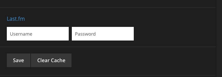

Since we're talking caches here: there's also a clear-cache button on the Settings /Music Player Deamon page. Wouldn't it be helpful to change the Cache Button names as to avoid confusion and reflect their respective uses a bit more precise? Of course if they are not referring to the same Cache that is. ;)
Cheers,Marius
that clear /mnt/img/tag_cache, essentially the MPD database file
Chris

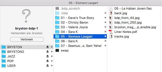

Just noticed that since I've enabled Bryston DB and Artist view (and let MM create the bdp_ images in the album- folders) my carefully selected and/or created album art doesn't show anymore. Only the cover.jpg are viewable, all others show a black empty placeholder. (back.jpg, cd.jpg, tracks.jpg etc etc)
Also, previously an image file name was shown in a tooltip when hovering the image. That too doesn't show anymore.
Chris, is this as expected, or are we talking bugs here?
That's been like that for a long time. I stopped creating back images because they never appear in the MM UI.
Not in my experience, at least not before using the Bryston DB and Artist view. Had nice track lists and back covers for many albums.
Hope Chris will repair this soon, it is a very nice, not to say necessary feature to have all tracks in view without having to scroll back to the relevant folder .

next to the extra bdp_front_44/250.jpg  files, i discovered several bryston_msg_mp_enable.jpg files. What is the purpose of these files, and why are they occurring at several and not all folders?
