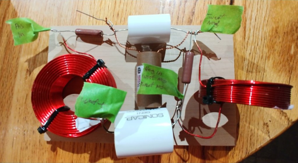

Danny or anyone who may know. Here is my interpretation of the NX-Studio Monitor Crossover schematic. Does this look correct?
One thing that would be a great addition to the kits Danny is if you could include a photo of the crossover for each design. Would save a lot of head scratching for newbies.
Sorry about the blurry photo. Hard to get good light indoors at night.
(Upper left) Positive in. (Left of center) woofer positive. (right of center) Negetive in/ woofer neg./ tweeter pos. (upper right) tweeter neg.
This is my first crossover build so any thoughts on my lay out are appreciated.
Thanks!

Re: Crossover assembly 101
« Reply #185 on: 6 Mar 2020, 03:40 pm »
Maybe... wires with heatshrink.
Sonicjoy
  • Posts: 366
« Reply #186 on: 6 Mar 2020, 04:21 pm »
Thanks Maty. The kit comes with heat shrink but I'm not ready for that yet. Just trying to confirm the layout and connections. I'm not new to wiring things (cars, boats, houses and audio systems etc.) just have not assembled crossover networks from scratch before.
Danny Richie
« Reply #187 on: 6 Mar 2020, 04:38 pm »
Thanks!
Looks correct from what I can tell. And if you run your wiring correctly then it should all work.
check the pictures on the first page to see how wires are twisted together and connected. That might help.
Sonicjoy
  • Posts: 366
« Reply #188 on: 6 Mar 2020, 09:26 pm »
Thank you Danny!
The final version will be neater looking. This is just a test fitting.
You mentioned earlier that the caps should all be oriented the same way. Is that electrically or visually? And if electrically how would I determine that?
