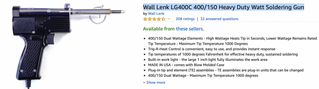

Danny, I saw that you recommended the Craftsman Dual Heat Soldering Gun. It looks like its temporarily unavailable from Craftsman.
Does this Wall Lenk Soldering Gun look like the same gun? or does anyone have experience with it?
That looks like the same one.
