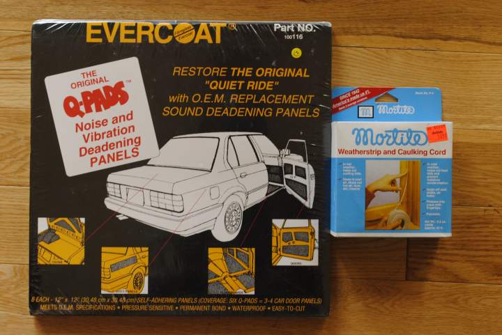

Well, I didnt leave well enough alone! I made some tweaks that takes my Lores to the proverbial "another level."  I purchased some Evercoat sound deadening panels from the local NAPA auto store, and Mortite caulk rope and self-adhesive felt from the local True Value. Total cost about $34. Essentially, I
1) damped the inner cabinet walls above, behind, and to either side of the main drivers (behind the fiberglass)
2) damped the inside of the front baffle below, and to either side of, the tweeter
3)damped the center of the brace (on which the crossovers sit), as well as the underside of the brace directly below the crossovers
4) damped the outer sides of the legs of the main driver frames
5) damped the (much smaller) legs of the tweeter frames, and the center rear of the tweeter frames

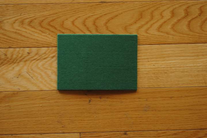

6) placed self-stick felt on the inside of the legs of the main driver (facing the cone), as well as the rear of the tweeter frame/magnets
5) used Mortite caulk to fill and damp the space between the magnet and frames of the main drivers
6) damped the capacitors using small pieces of Herbie Audio Lab DB Neutralizer I had left over from other projects
The Results? Easily noticeable more dynamics, a bigger sound, and clarity (clarity that seems to extend backwards into the soundstage), with no change in tone, and noticeable greater sustained notes...and quicker ending of notes.  In my system and room its the equivalent of moving a few rows closer, without the peakiness effect.   Total time: about an 1 1/2 hours (includes cutting materiel, taking out and replacing the drivers, and just looking around!)
I did not go overboard on any of the dampening: Roughly 6"x6" pieces on the walls around the main driver, 2"x5" pieces on the front baffle and cross brace (with the cross brace pieces doubled-up), 1/2" x 1" pieces (dampener and felt) on the capacitors (no felt on the capacitors)and outer legs and inner legs of the main driver frame, 2.5"-3" square pieces of felt behind the tweeter magnet/frames, and small pieces just to fit the small legs of the tweeter frame.  The sizes are not exact...and I assume can be varied.  I thought about applying the full 12" sheets to the cabinets...but decided to be a bit measured.

Why the tweaks:
1) I've always damped amplifier chassis' and CDP capacitors with good results, and had good experiences damping Klipsch cabinets and horn throats
2) I saw multiple times on the net where people talked about damping the outside of driver frames to reduce resonances reaching the cones, and adding felt to the inside of those frames to minimize reflections to the cone.  The Lore's main driver frame is pretty solid and thick, and did not ring with the "flick" test, but I figured a small amount of dampening would not hurt.
After futher listening to several Duke Ellington orchestra and Wynton Marsalis playing chamber music recordings (and a fully warmed Dayens!) the Lore signature remains warm, but is significantly clearer in the space between instruments and voices.  Yes, a veil or two has been removed.  The presentation is more forward but, unlike the Horns, the whole performance(s) seems closer, as opposed to individuals or sounds jumping out. I'm trying to wrap my head around why it is more dynamic yet so balanced at the same time, and realize that much of the dynamics seems to come from the soundstage becoming much deeper and clearer.  I can localize everything based on sound throughout the stage/venue. Performers that are close miked still jump out, but sound even more 3D, as if I'm hearing around them. Go figure.
I can not ell exactly what tweak made the improvements, or to what degree. But without much time and money, an already great speaker really ups the ante.
