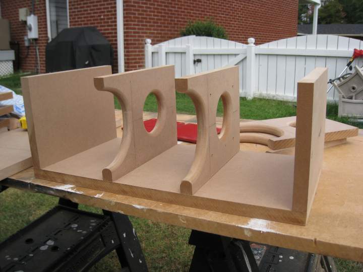

Re: Sealed Type N3 Building
« Reply #18 on: 30 Jul 2010, 12:08 am »
 Started building a pair of N3S's earlier this week. So far, I have assembled the sides, top,bottom, braces, back, and built the high and low pass crossovers. Crossovers have Sonicap caps with Platinum bypass caps and Mills resistors. Hope to finish the enclosures friday, sand, prep,and veneer in cherry on saturday.
 The following are some pictures showing the progress so far. I will post pictures next week of the finished speakers.
