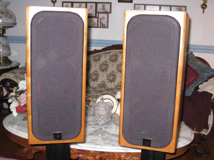

 Finally finished the grills this morning for the N3S's. Attached are a couple of pictures of the speakers with the grills on. I'm pleased with how they turned out.

Love the grills Ron, How did you attach the fabric, spray glue, Scotch 77?

Neal - I use 3M Super 77 spray adhesive. Works quite well. The grill frame is constructed out of 1/2" thick MDF.

Thanks Ron, that is what I used on my OB7 grills, but never heard it mentioned in any other thread. I was hoping it was the right stuff.
Thanks again for the posts and pics.
