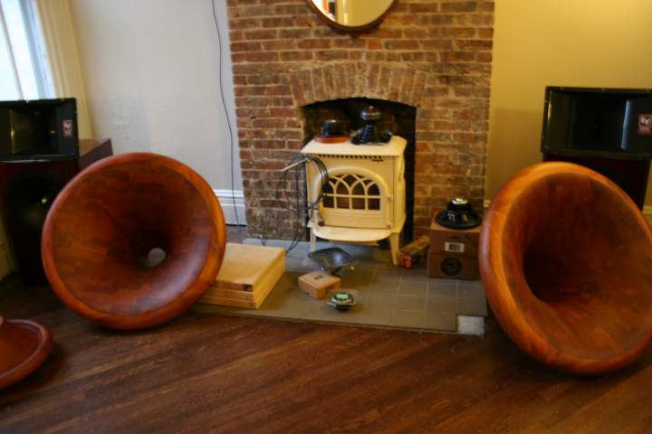

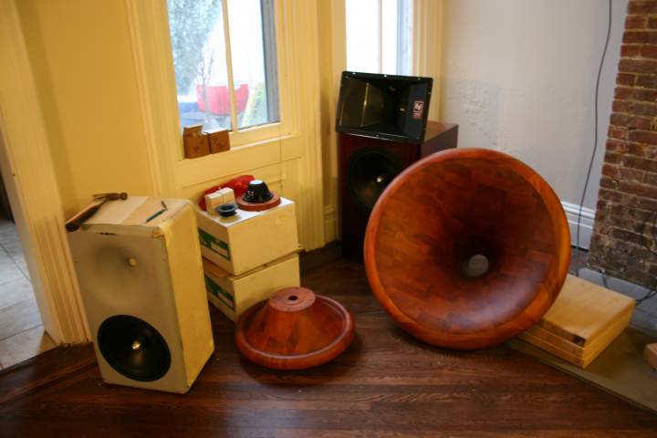

Thanks, Nullspace.  Its going to be a while before I have everything set up but once I do if you are ever in this area you can stop by.
The waveguides were my attempt to marry the OS profile with a LeCleach mouth rollback.  It doesn't end up being much different than a large roundover however.
All the horns came out well.  Now, I got to build stands to mount everything and then start measuring.  I have been quite busy the last couple of months and hadn't much free time to play with toys.  I intend to use some of the winter weekends to start working on that project.
As you can see in the one photo, my Abbey clones' boxes are done sans finish.  I am going to wire them up and prototype the XO soon.  Those speakers will be my HT speaks.  Some of the other projects in the background are the surround speakers which will be Econowave Delite 10Es (18sound XT1086 + DE250 + Kappa 10").   I got a number of subs in the works too.
Oh, and there are the EV 940 horns.  These are CD horns meant from 500hz up to 5khz iirc.  The drivers are Community M200As.  These are the same drivers that Avantgarde uses in their Duo and other speakers.  They are meant to be used from 400hz - 4khz.   They don't have an intended project yet but I plan to play with them.

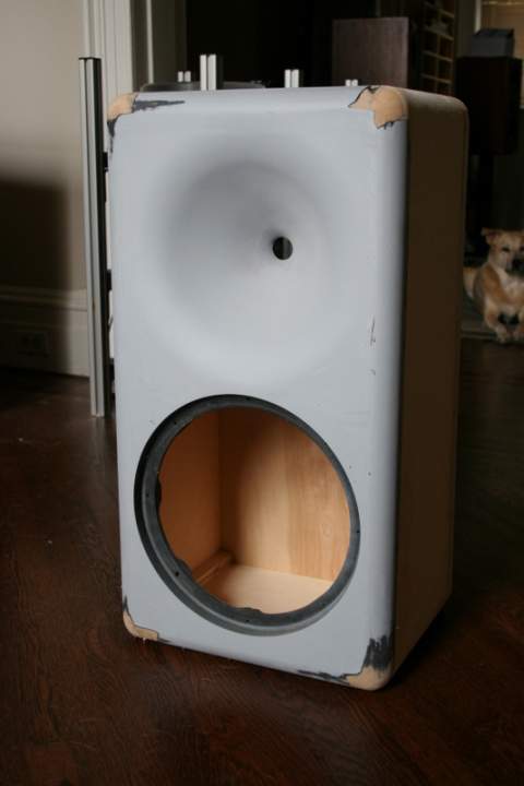

Abbey Clones...
The woofer has its own volume.  I intend to add a hinge to the door so the xo can be accessed.
