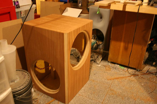

ok, so an in progress pic.
You can actually see the MT in the background in its current state (primer on baffle + raw sides).

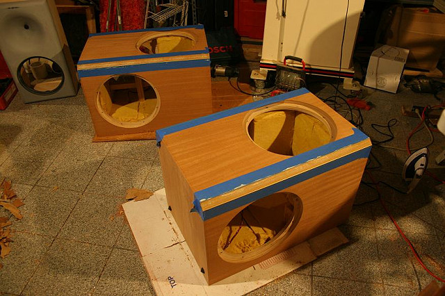

Putting on the last pieces of veneer, the chamfered sides.  Then it is onto practicing with anoline dyes.  The goal is a bombay mahogany finish.  There are a couple of places where I dripped a little glue so it is going to be a challenge to get it looking perfect.
