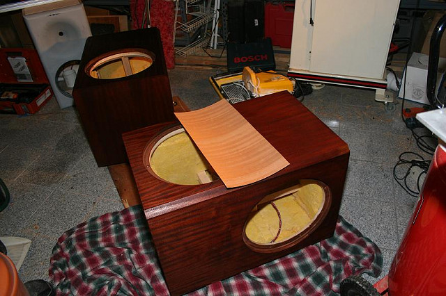

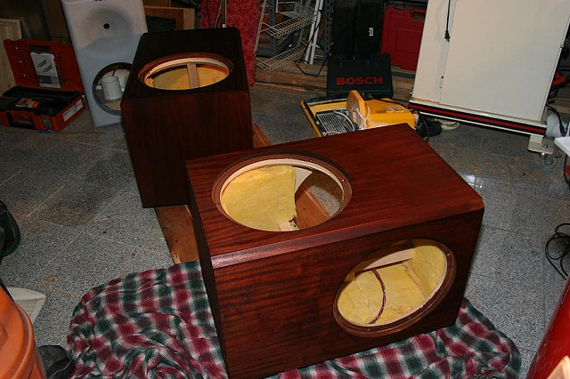

A sneak peak at the finish job. Only one coat of shellac, but you get an idea what they are going to look like.
I put a piece of the original veneer on the cabinets for comparison purposes.

In case anyone wants to know how *I* did it.
This is the method I used.
I wanted a dark mahogany look like the bombay mahogany finish that is common, or used to be more common. I am not into light wood, or really modern finishes. This is just me. Its current taboo to stain wood, but I find this finish more elegant than many others. So I am not to be persuaded.
HTguide.com is full of hobbyiest who build speaker after speaker and amateur and pro woodworkers alike. It is filled with tips. I noted that many recommend aniline dyes instead of stains as they tend not to hide the grain as much, only darken. Bingo!
There are two common ways to use dyes. One with water as a solvent, the other other with denatured alcohol as the solvent. I used denatured alcohol (I think in canada it is called methylated spirits). The reason are that water raises the grain, which needs to be knocked down again and alcohol doesn't. Since this is veneer and the thickness is limited, I opted for alcohol.
Follow the mix directions on the transtint. The mix quoted is 2oz of dye to 2 quarts of alcohol. That is a lot of dye mixture, more than I used on the whole two gigantic speakers. So I cut it down.
Notes:
1 quart = 32 ounces
1 ounce = 6 teaspoons.
I mixed up about 16 ounces of alcohol and >1/2 ounce of dye. I went a little heavier on the dye as I wanted a darker finish (the directions indicate this). This gave me just a little left over. Use a piece of scrap veneer to test the mix. Another hint: going over the same piece more than once does darken up the piece, but there seems to be a limit on this. The second swipe is close to what you are going to get.
Now, you are suppose to use boiled linseed oil or tungoil after the dye step, but I forgot. I would suggest it, as it heightens the grain character.
Then onto shellacing. The best procedure for padding shellac, that I found, I link below.
I bought my transtint from here:
http://www.homesteadfinishingproducts.com/htdocs/TransTint.htm
Mostly, as I wanted to patronage Jeff Jewitt's business, since I found his tutorial on padding shellac to be priceless.
http://antiquerestorers.com/Articles/jeff/padding_shellac.htm

Those are looking really nice Josh and will be sweet when your done. Looking forward to your thoughts on the finished setup.

I put another coat of shellac on Saturday night. I think they will end up a bit darker than seen in the photo.
I hope to put a layer on each night this week and have them ready for the drivers by the weekend. I might throw a DE250 on the QSC waveguide and fake a two way until the 11horns waveguide is made.

Final coats went on this weekend. I finally got some time to do it. Just didn't feel like doing it when I got home after work last week. I have to buff them out as a final step.
Its going to be hard to not be able to play them now that they are finished. My waveguides won't be done for a while it seems. I'll have to see if I can cobble something together for the upper range.
I couldn't work on other projects in the basement during the finishing time as I didn't want to create dust. It was hard enough to keep all the fuzzies off the finish.
With the bins out of the basement, I plan to start on the tapped horns and do a bit more finishing of the MTs.

I used Crystallac over the Shellac to make a more protection finish. The bonus is that cyrstallac makes for a very nice finish. Its super clear and glossy.
These aren't even buffed out, but you can see your reflection at some angles.

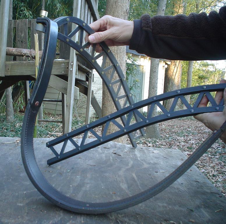

Just received a picture of my commissioned waveguides.
pictures of the 140hz LC horn (not my pair) can be seen here...
http://hifiheroin.blogspot.com/2010/03/304th-for-size-and-scale-reference.html

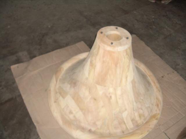

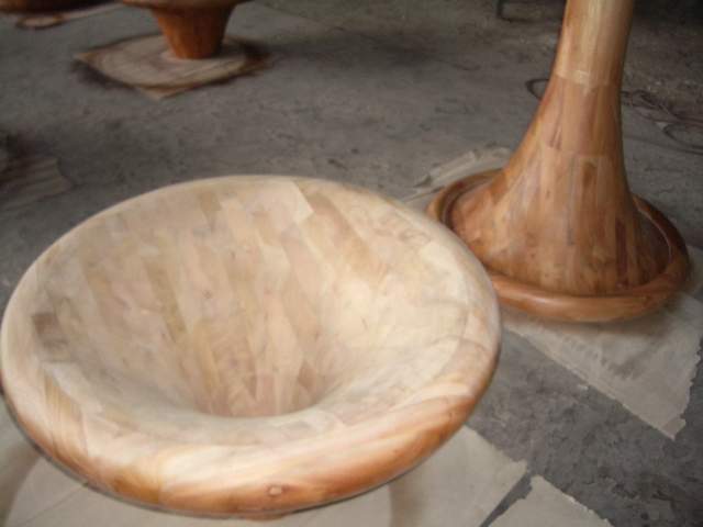

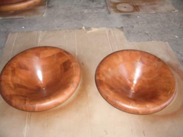

My 140hz LeCleach horns prior to finishing.

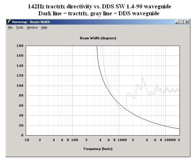

Chart from John Hasquin demonstrating the directivity of a 135hz Tractrix and a 24" DDS OS-like waveguide.
For my start, I assumed that the 142hz LeCleach profile would produce a directivity similar to a 135hz Tractrix and the DDS is going to be in the ballpark of my custom waveguide. Actually crossover point will be determined from real measured data.

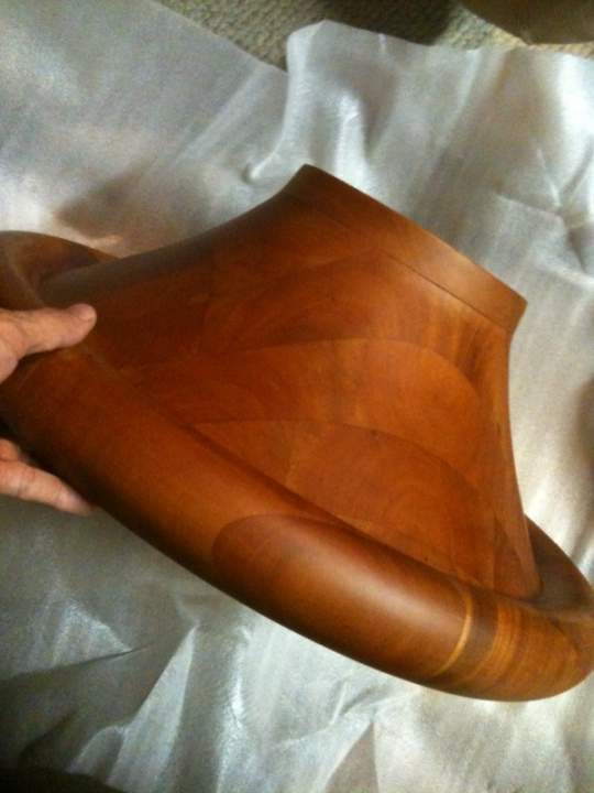

Just got back from a week in Honduras but I was able to see the horns before I left. They are huge! I expected as much but still to see them in person is something entirely different.
It will take me a while to get them set up. I may try to knock out a simple xo so I can run them on one amp till I have time to take lots of detailed measurements. I am not sure I have enough channels of appropriate amplification to use the DEQX.
http://hifiheroin.blogspot.com/2010/11/pile-of-horns.html
