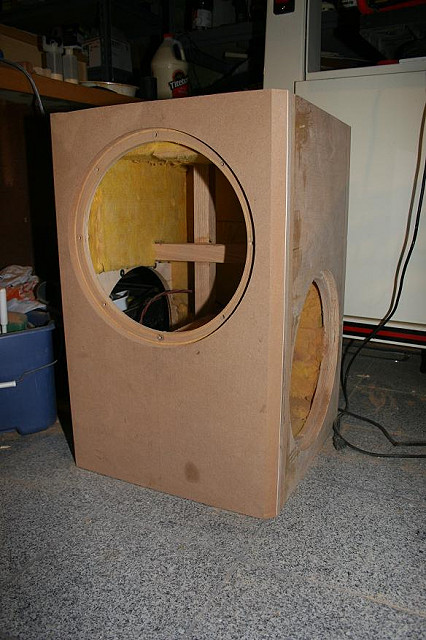

Great stuff here Josh! Keep it coming... Can't wait to see how it turns out.
I feel you on the pain of the finishing. What do you plan to do, paint?
I always do at least 2 coats of the glazing putty. And don't forget to cover the roundover with it.  I made that mistake...
-Tony

I am planning to veneer the bass bins and paint the MT.  Maybe I'll veneer the sides of the MT, maybe not, we'll see.

thanks.  I am attempting to make this thread sort of a "build thread" just in case it inspires anyone else.  However, I am not organized enough to make it a true document of my build process.
I have to thank for forum members for pointing out the single tube glazing putty.  It definitely works a lot better than the two part stuff for small imperfections.

looking good bud.. I tend to use duraglass which is more autobody stuff for filling holes and dips.. IMO, going the autobody way seem to last longer as the products are made to handle extreme temperature and environment issues.
have you veneered before? it's not hard at all... I did the Elise set with wood glue, non backed veneer, an old t shirt and a clothes iron...

I've done some veneering, but not on a completed project (well except for one disaster, I like to call a learning experience).   I used the iron-on method and it works really well.  I am definitely doing the same this time.   I just need to do a little bondo'ing of a couple of of hte corners as they weren't perfect in a couple areas.  After that I'll veneer.
Grab yourself a tube of Bondo "Glazing and Spot Putty" instead of the body filler.
I've used both, and for smaller fills, the Spot Putty is MUCH easier. The stuff I got isn't a two part, so there's no mixing. Also, the working time is much longer. Another advantage, is the Spot Filler sands "equalier" to MDF than the diamond hard body filler.
Bob
p.s. Sorry to make up words, but it sounded so right at the time.

Thanks Bob.  As I mention, I was recently made aware of the 1 part stuff and it is definitely a lot better to work with for fine details.  In the case I was referring to though I actually have to build up a seam a little, as my joint wasn't perfect.   On most all seams I left a little overhang and used a flush trim bit to true it up, but I did goof on at least one partial seam.
If it were just a little bit larger of a mistake I'd rabbit it out and epoxy in another piece on that seam, but I don't think its worth that much effort, I'll just smooth it over with bondo.
Famous last words.  :lol: Been there, done that Brother. (sorry, that's a private joke between me, myself, and I)
What you've got going for you is that the final "coat" will be veneer as opposed to paint. I've had a hard time keeping the seams of laminated MDF layers from "popping through". Even after multiple coats of fiberglass resin.  :roll:
But the veneer will hide all but the nastiest of mistakes, you'll be fine.

I had pretty good success using minwax wood filler on any true seams/ gaps and sand.
Then to make that texture smooth as glass, use the single tube stuff over that and sand with 320 400 grit... and then shellac and re-sand.
-Tony

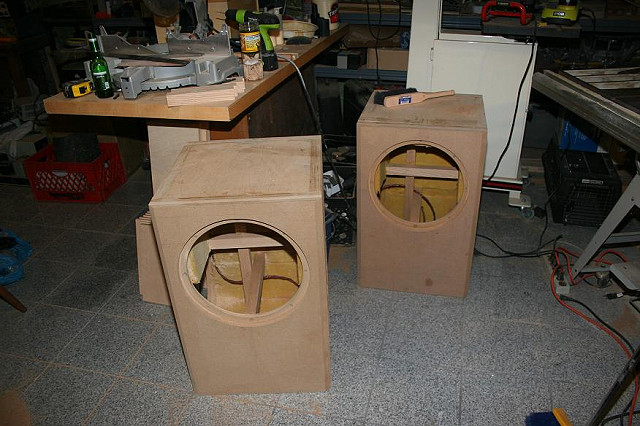

No pictures to show but I got the sides, top and bottom glued on the Blitzen (MT top).  I cut the veneer and laid down my first piece on the Donner (bass bin) **.   Its basically all finishing work now.
For the Blitzen, I decided on U baffles.  I'll be stuffing them to yield a cardiod response in the lower end.  This will hopefully transition the power response slowly and smoothly between the narrow CD response of the waveguide down to the omnipolar response of the Donner.
I've been taking my dear sweet time with these speakers.  I am in no hurry as I have a pair of speakers set up already for listening to music.  I think this is key, as I am enjoying this build process even more than some of the eletronic projects I've done.  I'm learning a lot along the way.
I've had my share of mishaps and snaffoos, but if you are patient, generally they are easy to rectify.  I think woodworking is about confidence, patience and measuring numerous times.
