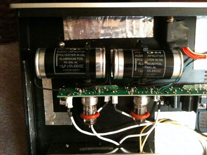

The best overall cap in our mind is the AMP OHM Polyester in Oil Aluminum Foil.
It is the least damaging to the sound, it is the most neutral sounding, the airiest, most detailed (great ambiance retrieval) without being etched or bright and by far the most extended top to bottom cap we tried.
On the negative side if your speakers are on the lean side it will not add beef to the sound like some PIO do. So "the best" not only depends on personal taste (and everybody listens differently and has different preferences) but also what basic system are you starting with and what improvements are you looking for.
Close seconds in our tests are the AMP OHM PIO Copper foil - very rich, seductive mid range, very good presence and tonality to die for, especially with horns and percussion - to my subjective ears it gets the most realistic sounding percussion I have ever heard.
On the negative side - it is not as airy nor as extended as the Polyester in Oil. So life is a compromise - pick your poison.
I would say Diana Krall will sound better with the PIO (more lush, sweeter, less raspy as if she had a cold or something :-)). Big Orchestral Piece will most likely benefit from the Polyester (especially tympani's or any large drum) due to its ambiance retrieval and good extension.
Ironically, the company went bankrupt and hence these caps are no longer in production. There are some talks about getting back to production (Audio Cap in the UK) but nothing came to fruition.
My friends recently tried Obbligato Gold Premium Caps and really loved them. They claim they are pretty close to the AMP OHM Polyester In Oil Aluminum Foil. I never tried so cannot voice an opinion.
For their low price they are surely a low risk buy.

OK fellas, I started the mods today on my JD-9. I started with the caps, and used Obbligato gold premium 1uF 630v caps for my replacements. Wow, there is just no way only changing caps should have that much improvement in the overall sound of the unit. I am pleased way beyond my expectations, I am using Siemens ECC 83 tubes which I like in phono stages and the sound is fantastic. I have a MFSL copy of Supertramp Crime of the Century on right now. So what would any or all of you suggest for the next step (op amps??), maybe someone can put the mods in some kind of order most improvement to least? Thanks guys.
Dan
Doronor
Re: Jolida JD-9A phono amp hybrid Magic...
« Reply #79 on: 30 Dec 2010, 06:05 am »
Hi Dan,
Glad you found out how good the Obbligato caps are.
These are the proof that one need not spend huge amount of money to get good sound.
I tried them in the input section as well (there are a bunch of 4.7 mfd caps near the op-amps) and they smoothed out the sound.
Also, just recently tried the Vishay Z-foil resistors to replace the 33 ohm ones (my Dynavector 17D3 has 0.3 mV output).
I used 47ohm but given the low cartridge output, I may try to bypass the
resistors altogether just to try (best resistors are no resistors).
The Z-foil is special: more information coming through without thinning of the sound. These are ultra detailed resistors.
More extension top to bottom as well.
All I can suggest is do one upgrade at a time to be able to track what each does.
