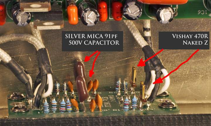

2. Replaced the 97 pf cap's
   * These are for the 100 ohm setting of the input board
   * SILVER MICA  was used
   * No issues soldering to the board, seemed easy enough to me
3. Replaced the resistors for my appropriate for my cartridge:
   * replace with Visay naked Z
   * I got the 470R and my output is a bit low but I was able to increase the output on my preamp so it worked out fine.
   * again, no issues soldering to the board, seemed easy enough to me

Here is exacatly what I bought from parts connexion: (not endorsing them but they met my needs)
   * 2 Vishay Resistor_ 470R Vishay VAR-Series "naked" Z201 Z-FOIL RESISTOR 1%
   * 2 Obligatto Film Cap 1.0uF / 630V, Premium Gold Film Cap
   * 2 SILVER MICA 91pf 500V CAPACITOR
   * WBT solder (just buy it or any high quality silver bearing solder)  It's worth 5 times what it costs, take my word for it please, do you self a favor...
Don't know if I did it all "right" but it sure sounds massively better.
Two pictures:
First shows the overview of the cap replacement and the hard wire of the channels
(important note, these replaced the original caps that I took out from the other side of the board)
Second shows the resistors, creepy looking Naked Z, and the silver mica caps...

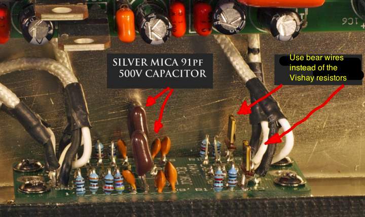

Doron,
   Im a bit confused by your comments. The Switches have nothing to do with the output rca's. When I switch from using the MM gain setting (1k resistor) to all switches off I get lower volume.
Doronor
Re: Jolida JD-9A phono amp hybrid Magic...
« Reply #115 on: 6 Apr 2011, 05:41 am »
Bigdirty,
My loading setting (capacitance and impedance are all OFF as I find this works best for my Dynavector 17D3).
When I use the right hand side dip-switch from the three dip-switches:
and use the right hand side output RCA's (the high gain ones), I believe this is the highest gain settings.
Are you claiming that putting all three dip-switches on "off" will increase the gain (bypass the resistor)?
I though putting them all in "off" will not output any signal.
Now assuming we are on the same page, my question is if anyone tried to by-pass the resistor behind the right hand side dip-switch (which dictates the gain - the lower it is, the higher the gain)?
By by-passing the high gain resistor I mean - use a bear wire instead of a resistor so the connection is there but without the resistance (or with negligibile resistance that is).
Like in the following photo:
