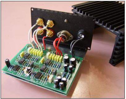

Glad to hear your search is going better than mine. I've heard great things about The Tube Box SE. The case for the solid-state was about brick-sized and brick heavy too. I was shocked to find absolutely nothing I would consider "audiophile quality" inside! Really, not that shocked after listening to it a couple days.
Does the second phono stage look like a new, improved version of the first one that should be sharing the same name and reputation? Notice how the case is twice as big as it needs to be just to deceive...

A friend has both the Phono Box II SE and the Tube Box II SE. We made a short comparison a few weeks ago. As far as I can remember was the difference not so huge, but the Tube Box was preferred for its warmer sound. Maybe you should also try the Tube Box II SE? If you still like the Jolida more after this you can keep it and don't need to worry about it any more.

« Reply #53 on: 6 May 2010, 07:17 pm »
Your pictures came with a little delay, it did not see them before. The II SE is entirely SMD'd which needs less space. The sockets are soldered directly to the pcb. There are 5 OPA's per channel whereas the old model has only 3. Electronics are getting smaller. IMHO this is indeed an improved version. Of course, you are right regarding your comments about the size of the housing.
I don't think 5 op amps is an improvement when 3 quality ones will do. Both models have all the parts soldered directly to the PC board. The difference is the new model uses cheesier op amps and those micro resistors and caps which I do not consider audiophile quality at all. Also, they cannot be upgraded or even replaced. The "improved model" is absolute rubbish compared to the old one. My ears told me that before I opened it up to see if there was any hope of getting good sound out of it. They ought to be ashamed of themselves selling that as "audiophile" gear for over $300.00. It's worth about $50.00 tops and there are more musical sounding $50.00 phono stages using full-sized parts. All electronics are not getting smaller, certainly not "audiophile" electronics. It's just that a couple companies went cheap. The only other phono stage I'm aware of that uses these micro parts is the NAD PP-2, another phono stage that doesn't sound all that great. Coincidence? At least the NAD sells for a much more realistic $100.00.

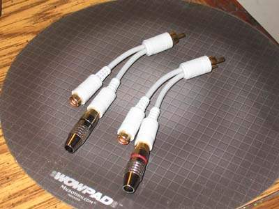

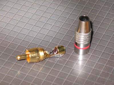

I just discovered something that made my Jolida sound twice as smooth. The overly "forward" sound is gone and both frequency extremes are smoother and more extended. I'm hearing deep bass I haven't heard from my vinyl rig in a long time.
The fix?... I found the capacitors for capacitance loading in the Jolida are tiny, cheap ceramic discs. Definitely not the first thing you want in your signal path. I turned off all the capacitance switches and used Y-adapters and loading plugs with silver mica caps in them instead. 91pF seemed about right for most modern  moving magnets that liked the 100pF setting. The Y-adapters add a little capacitance. HUGE difference. Smoooooth and more extended. Definitely try this if you have a Jolida you're not 100% satisfied with yet. It's no small difference and it's all for the better. I thought about replacing the stock caps with silver micas, but the stock ones are tiny and I'd be worried about ruining the PC board traces trying to install the larger silver micas with larger leads. The plugs and Y-adapters work fine though.

You want pics of the stock caps?... or how to do the capacitance plugs? I can take some...
The first pic shows how to use them. Just plug the plug into the Jolida, your turntable into one of the jacks and the loading plug into the other. The second pic shows the silver mica soldered into an RCA plug. They're non-polar, so just one lead to the plug tip and the other to the ground. I did use a cheapo heat sink clip with a 90 degree bent tip on the lead between the cap and where I was soldering. The plug tip particularly seems to hold a lot of heat for awhile. Not sure how necessary that was or how easily silver micas are damged by heat.  There are a couple dealers on eBay who will sell you a few silver micas without ridiculous shipping charges or a minimum order. You have to watch the size if you want to be able to put the covers on your plugs. I've bought some silver micas that are much bigger, even though the values and voltage ratings were lower (I believe these are 300 volt). Maybe older ones?...  I also found the plugs on eBay from a Chinese dealer for less than $1.00 each shipped. Pretty snazzy plugs... These really come in handy if you have a phono stage with fixed capacitance and a vintage cartridge that likes higher capacitance. Just have to find the right value.
