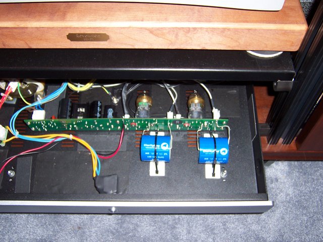

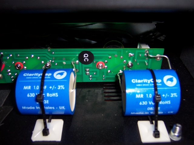

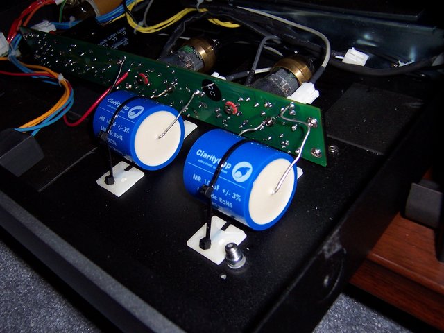

Hi Undertow, I would like to preform this mod (good work!) but from your pictures I can't tell which pins I need to solder the new caps to, can you take another close-up pic??
Thanks!
BP

Ditto for me (not entirely sure of which pins to solder)---I just ordered a Jolida JD-9A based on what your fine modifications will offer. Thanks for being so explicit with your directions and pictures--just a bit nervous about hitting the wrong pins.
