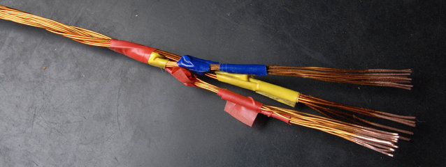

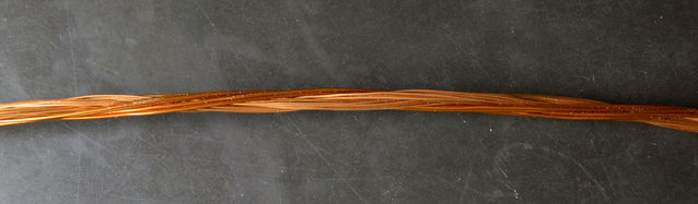

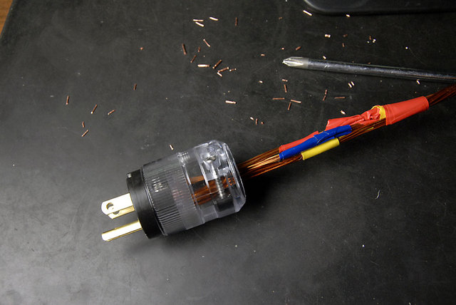

First and for most these are not bare wires, but certainly not UL approved either, so do your research on magwire and make or don't make them, I assume absolutely no resonsibility if for some reason you endanger yourself or others by your making your own.
PC construction from magwire: first 1 I did was all 18ga, and ultimately very stiff so for 2nd I used 22ga. increasing the wire count.
mag wire PC-2: my 2nd PC 12 hot 22ga./ 12 neutral 22 ga. / 6 earth 18ga.: before braid
Ideally the tape should be removed from the PC, but it being a PC and magwire- I wanted to make sure I know whats what if I open the plug for any changes.  Being that enamel is the covering its probably good practice to not touch them when plugged in, although a little paranoid on my part.  I still think error on side of caution these are not SCs or ICs, lots of juice flows thru them.  This particular wire is GP200.
I need to find my notes on the twisting I did, save the images to your PC and blow them up for closer study.  I will look for these, basicly the hot and neutral are twisted together first and lastly I twisted the earth around that twist.  At the ends I taped again to make absolutely shure there were no mistakes before termination.  I also have a volt meter.

That looks like the most dangerous power cord on the planet.  There's no way I'd touch that.

1000a, you can not play with the wiring in my house, ever. You will keep your hands off of my audio equipment. You will not be allowed to get anywhere ear my daughter or any of my nieces. Anyone who wires line cords up like that should be barred from major or minor construction projects and probably should be put on a list somewhere as "a menace, dangerous to safety".
zzzzttttt .... smoke, stink ....

hey guys if you think its really that bad should i pull the post, seriously i do not want anybody to endanger themselves with something that is unsafe?
they work for me but I do NOT want to give anybody a bad idea.  serious I can delete it! :o
It should be noted magwire is self insulated with very durable enamel with high abrassion precautions, these are not BARE WIRES!   this particular wire is rated to 200 C.  they are typically used in winding motors, transformers and such.
Please let me know if I should delete this, I really to not want to encourage dangerous practices. :scratch:

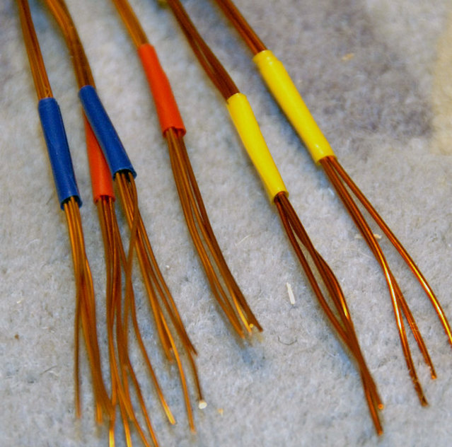

Here are the stripped wire ends, on GP200 I had to use a knife to remove the enamel covering that insulates the wire.  Obviously one needs to be sure in the termination of such that no bare wires from the neutral, hot or ground are touching each other.
If that knowledge is not at ones disposal, all your wires should be commerically made.

You can find a commerically sold magwire PC at Mapleshade audio on their website and a power strip with the same. In such case they have fewer wires rubbing against one another that may make many feel more comfortable. and can certainly purchase that one, which I am quite certain will amaze you.
if one trys a cord such with the wire I used they will find the stripping of the wires guite a project (way over an hour) the stuff does not yield easily even to a knife!! (ref GP200)
