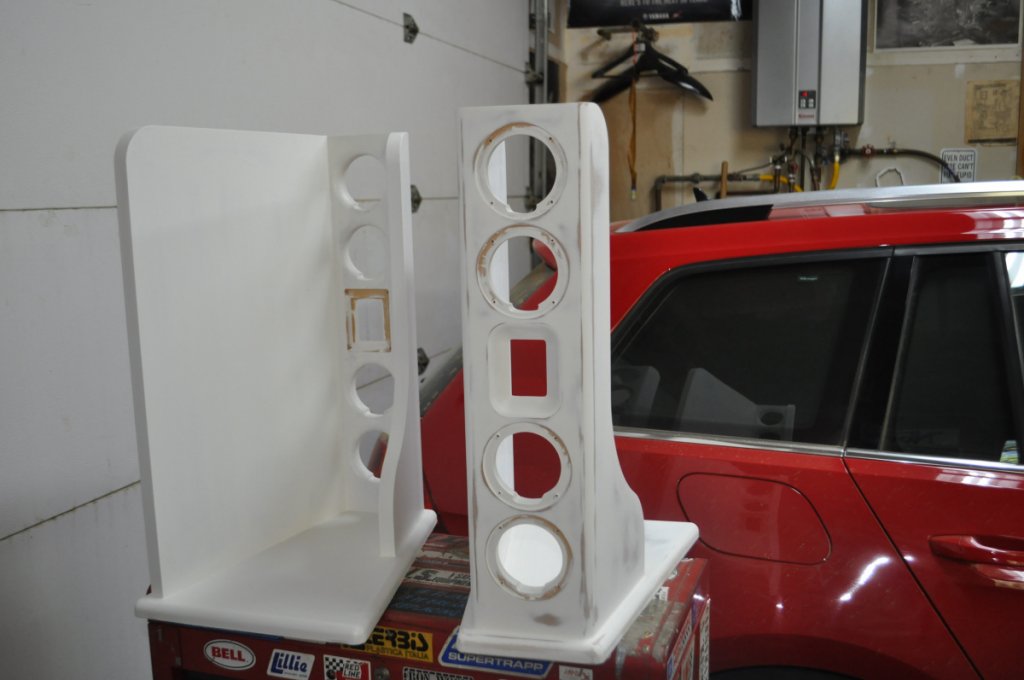

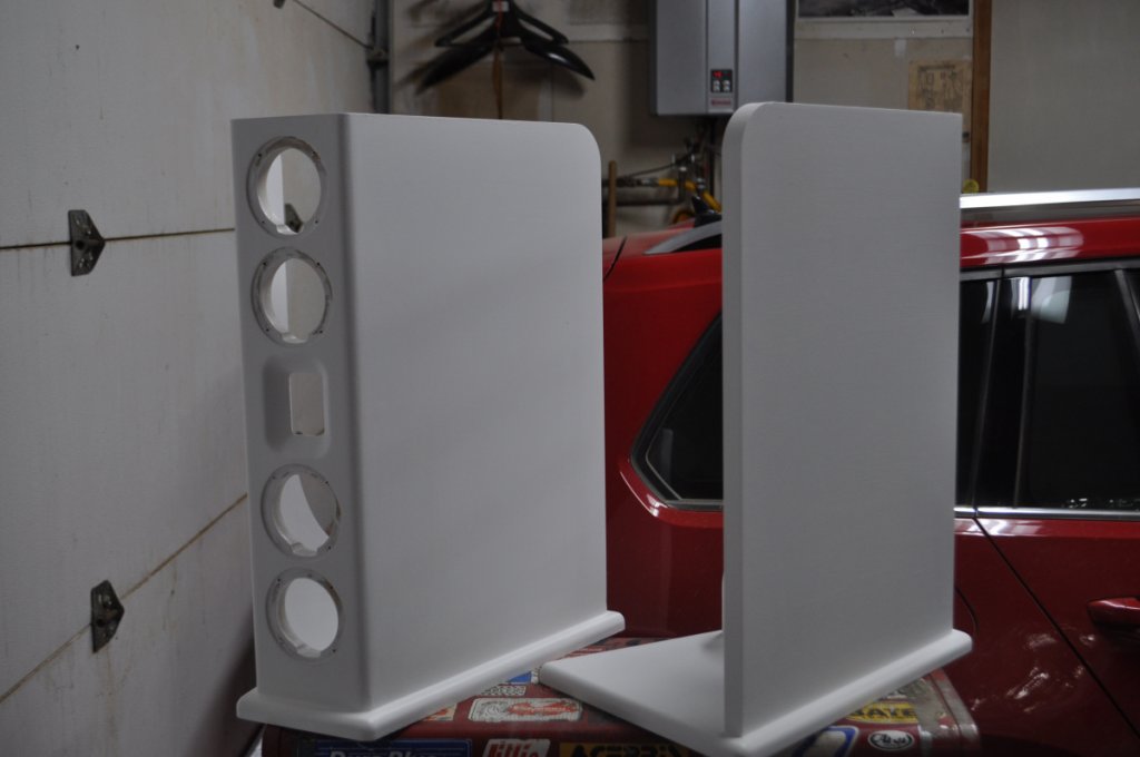

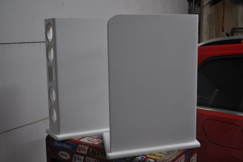

  I, hate that word sorry, worked on the second baffle today. Two coats of primer. The first one is finished as far as I'm concerned. Ready for color. I'm using General Finishes milk paint and I'll brush it on. second baffle needs to cure and I'll sand it tomorrow and add more primer if needed. The top coat is going to be white.

  I'll do another light sand, then another coat.
 I'm using a roller to apply the paint.
