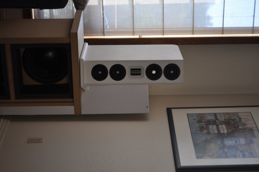

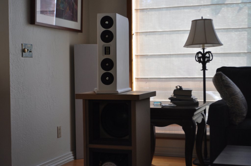

 The last coat went on this morning. Letting er' dry and I'll button things up.
mkane
  • Posts: 488
Re: Painting Speaker Cabs
« Reply #22 on: 16 Aug 2022, 10:09 pm »
  I had to do a fair amount of scraping the get the woofs in place due to paint build around the perimeter. Not perfect but our house isn't a  museum.

They look nice. Looking forward to hear your thought on them paired with dual servos.
mkane
  • Posts: 488
« Reply #25 on: 17 Aug 2022, 12:37 am »
 Thoughts. Fantastic. I've had them for at least a couple of years. I chased open baffle magic for quite a while and stumbled on to GR Research. Not soon enough. Spent a fortune chasing that sound.
Personally, I don't like the bright white but I have to please someone else in the house also.

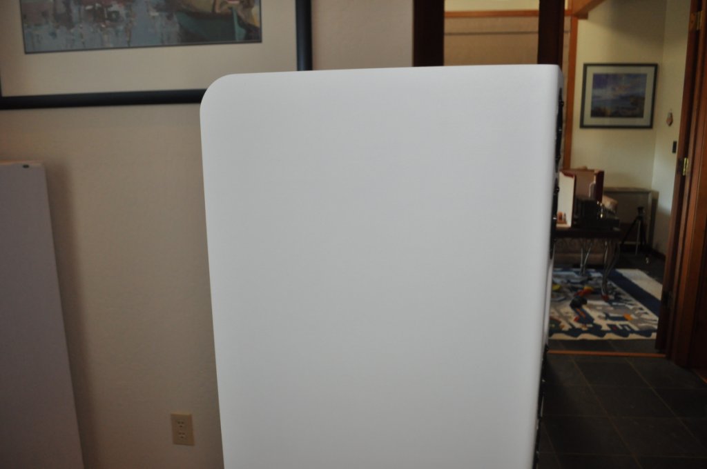

Finished with the sealer part of the process. Very happy with how they turned out.
Luckily the weather cooperated with a bit less humidity, so dry times were less than I anticipated.
I applied three coats of the Knisser Cover Stain. With the first coat I used a brush, and wound up with the brush marks again. Sanded  with 220. Switched to a roller. The roller left a texture, but I got better coverage and was able to sand to a pretty smooth surface. The third coat was the key. Finished sanding with 400 grit.
I have a nice Bosch sander, but did all the sanding by hand. I felt I had more control that way. A lot of work, but worth it.
Now waiting for my paint to come in. Plus I guess the kit is still 2-3 weeks out, so no big rush.

mkane
  • Posts: 488
« Reply #36 on: 21 Aug 2022, 03:52 pm »
  I also started with an orbital sander. Hand sanding worked out best.

Hey mkane, just curious. Did you use more that a quart of paint for your cabinets?
mkane
  • Posts: 488
« Reply #38 on: 23 Aug 2022, 02:26 pm »
I did not. The first coat went on without being thinned. The second coat I thinned a bit. The third coat I thinned even more.
