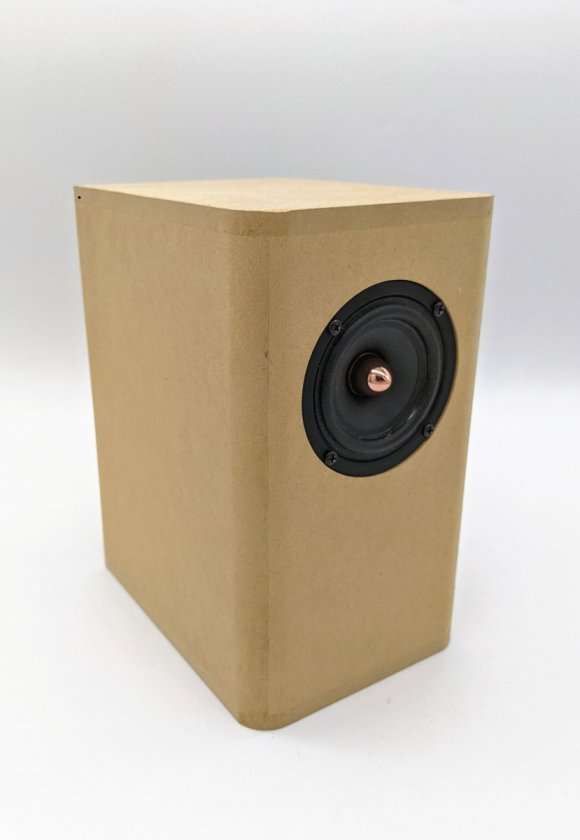

Hi yall!
The LGK 2.0 kits are coming soon!
We just finalized the crossover design this morning.
Just in time too! as we're about to run out of the tweeters for the Mini's.
Some quick specs for those curious:
Cabinets are 9.5"x5.5"x7.5
Slotted port is tuned to 80Hz
~84 dB effeciency. +/-1dB
Nominal impedance of 6 ohms (4 ohm dip at 15KHz)
Back panel is removable to mount the crossover. Either to it or on top of the port shelf.
Crossover will use 7 parts in total. (8 if we include a bypass cap option)
Next step is to build out a test pair using some finished cabinets, and make some videos announcing them, as well as finalizing the prices for the kit/flatpack upgrades.
We should have everything ready to go within the next couple weeks! :thumb:

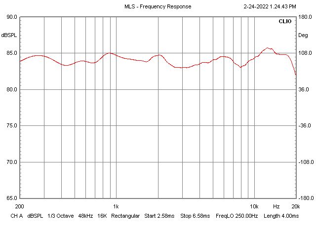

« Reply #18 on: 25 Feb 2022, 10:06 pm »
More aptly called a filter with only one driver. I'm pretty sure baffle step correction would be part of that.
It's actually just 2 notch filters, one parallel and one in shunt. Totaling 7 parts
The original design we started with used a baffle-step filter then 2 notch filters, totaling 10 parts.
I spent some time playing around with the network and managed to get a little better response with 7 parts.
The baffle-step compensation was converted to a parallel notch filter.
here's the measured on-axis response:
Danny Richie
Re: LGK 2.0 Preview!
« Reply #19 on: 27 Feb 2022, 12:25 am »
Hobbs has been learning quite a bit about crossover design and he did do some tweaking on these to see how far he could take them. He did a great job and what he came up with may be what sticks in the final design.
He has also been learning about tweeter wave guides and has been 3D printing some prototypes that turned out really well. So you may see a few of his marks on some of our new designs.
