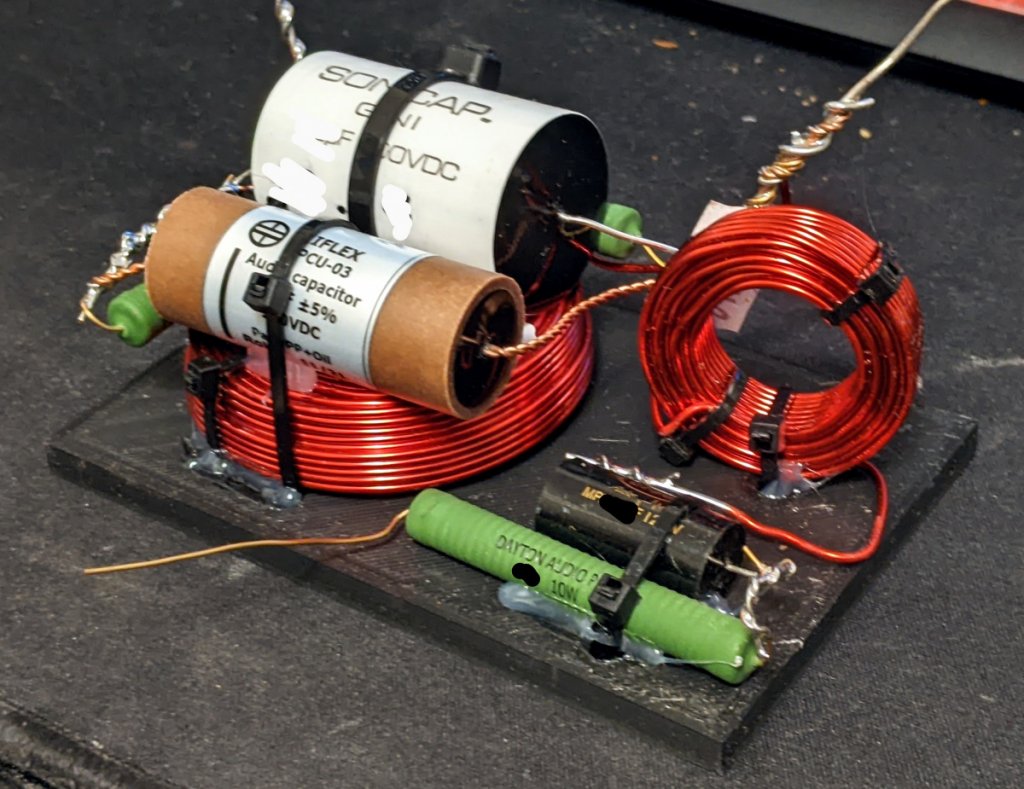

Space is tight so the crossover will need to be mounted to the top of the  port shelf.
Its 3" wide by 4.5" long

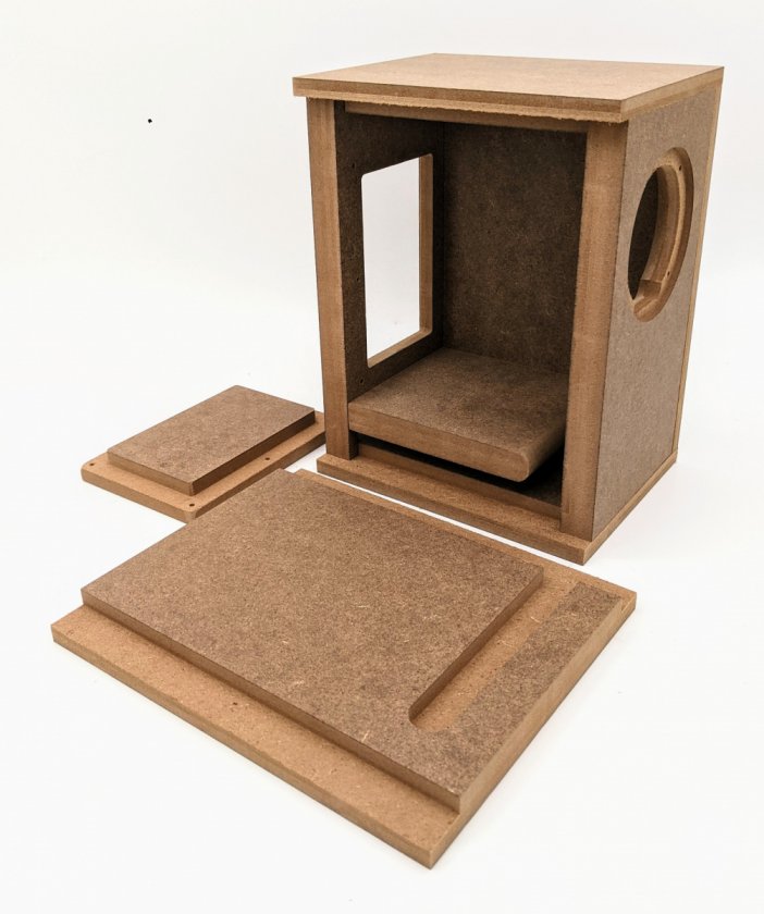

Here's a shot of the flatpack:

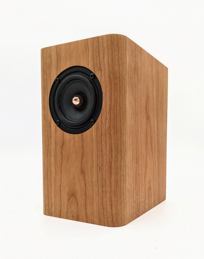

Finished Cherry cabinet:
Expect more news and pricing soon!  :thumb:

Just note that the crossover & wiring will need to be installed before sealing up the cabinet.
It won't fit through the woofer hole.
With the flatpacks we'll be using removal panels to make them easier to install the crossover.

Danny is also leaning towards using the Gen3 Sonicap as the optional bypass, instead of the Miflex caps I used.
Mostly to save on space.

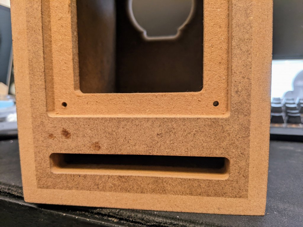

May i see the slot in the back?
Hobbsmeerkat
  • Posts: 2741
Re: LGK 2.0 Preview!
« Reply #33 on: 23 Mar 2022, 05:47 pm »
Sure!  :thumb:
You can round over the slot if you like.
4" wide, 5.75" deep 1/2" tall

 Hobbsmeerkat
Can you move the slot to the front if they are going to be on a desk and very close to the wall?
Hobbsmeerkat
  • Posts: 2741
« Reply #35 on: 23 Mar 2022, 10:32 pm »
Unfortunately not. The original plan was for a front-port design.
However It created a hump in the response around 200-500Hz, which would habe needed more parts to address.
It should be possible to do a down-firing port and build legs to get it off the desk. Otherwise you would need to make a port that is 3/4or 1" in diameter and roughly 3" long. But it would probably need to be custom made, as there aren't many tiny ports, especially that size.
You may be able to loosely stuff the port with poly fill to help dampen the output of the port.
