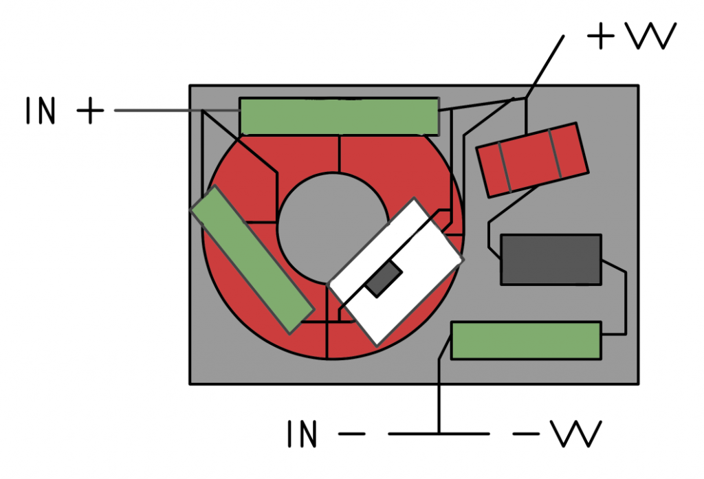

Ok now I'm assembling the filter. Whats the small unmarked cap for and where does it go?? I'm counting 8 parts but seeing 7 on the schematic. I feel stupid
 Is there a photo of this most recent version of this? Thanks
The unlabeled cap is the 0.01uF Gen 3 Sonicap bypass.
It bypasses the main Sonicap in the circuit.
Gimme a second, and ill draw something up on how it should be assembled with the smaller bypass.
done! :thumb:

Thanks! I think my schematic is missing the bypass cap and has one of the resistor values listed incorrectly. Is that possible or could I have been reading it wrong?
Hobbsmeerkat
  • Posts: 2741
Re: LGK 2.0 Preview!
« Reply #72 on: 6 Apr 2022, 03:27 am »
Hard to say. Ill need to double check the schematic so see what's written on it.
Shoot me a DM with the value you think is wrong and I can verify if what you have is correct.

I looked at the schematic and it is correct.
Placement  order is a little different than what I drew, but still works in exactly the same way.
