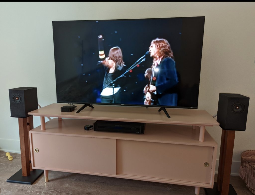

Elon made the crossovers in these and they were perfect!  Beautiful, and incredible work!
Here is a photo of the LGK 2.0's all setup!
Using a Emotiva TA1 receiver/amp, and Monoprice speaker stands, so happy to see actual hardwood when opening the speaker stand packing.

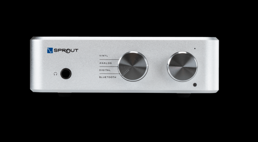

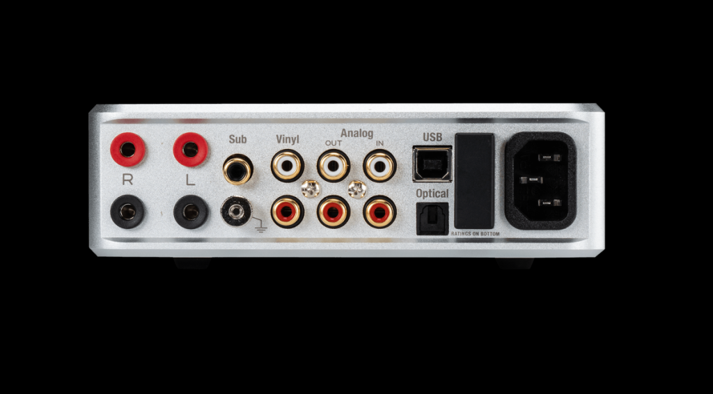

I am working on my LGK build and will use with my desktop PC.  Looking at possibly one of the Schiit devices for the DAC.  What about an amp?  I won’t be using headphones.  I don’t see much of anything regarding an amp for desktop without a headphone plugin.  Does anyone have recommendations for DAC and amp for PC that will pair well with the LGK?  Thanks.
mlundy57
  • Posts: 3643
Re: LGK 2.0 Preview!
« Reply #91 on: 10 May 2022, 11:16 pm »
I use a Pioneer network audio player (streamer/DAC) and a Rotel RA-12 amp with my LGK 1.0s.
For an all Schiit system you can add either a Vidar or Aegir to which ever DAC you choose.
My recommendation for a one box option is the PS Audio Sprout  https://www.psaudio.com/products/sprout100-integrated-amplifier/  . This is an $800 complete option though you can trade in gear and get up to 30% off bringing the Sprout to $560.
The reality is that since you will be sitting arm's length away from the LGKs, you can power them with any amp you wish. In a desktop setup they will never need more than a fraction of a watt.
