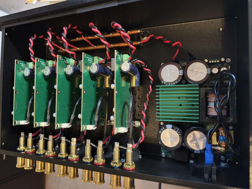

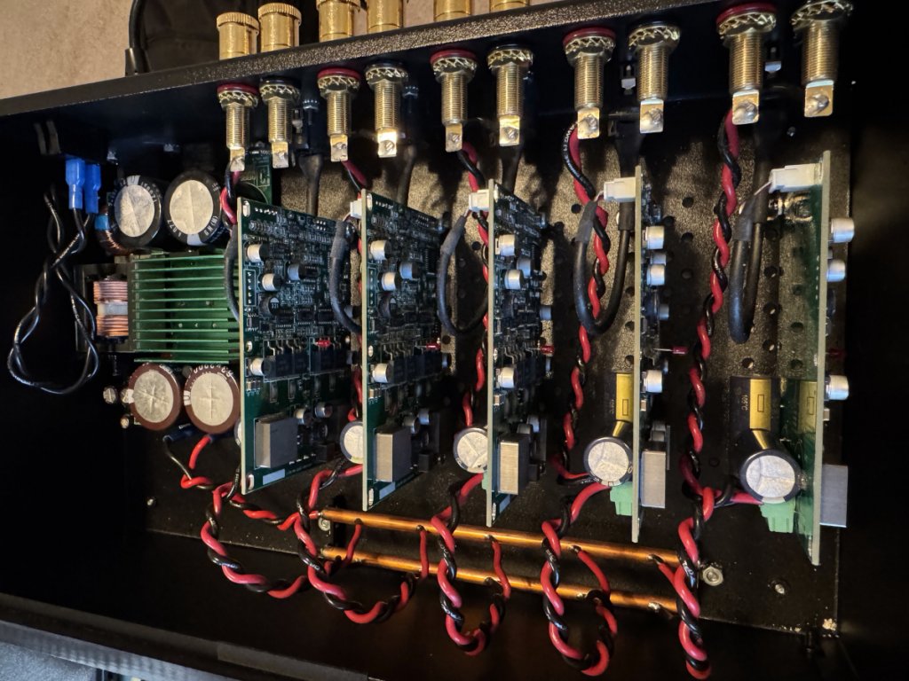

Hi,
I’m curious how did this work out for you? I’m not sure if you had a similar issue with your Cherry amp. But my 5-CHerry won’t power on. I’m wondering if it’s just replacing a power supply on my amp as well. I took some pics of the inside of my amp to see if it may be something I can fix but the fuse looks ok, although two of the caps do look a little bulgy? Any suggestions welcome.
