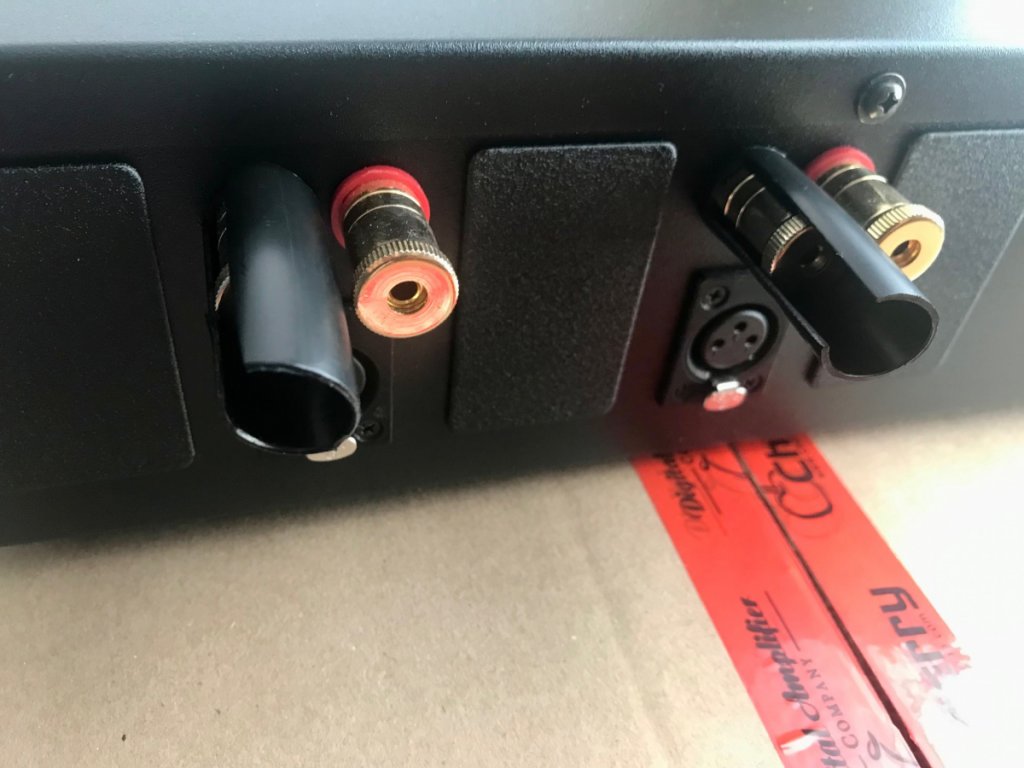

I would like to say again that using a binding post sheath such as in the photo below is critical for Tommy's amps. Many amps have binding posts that are farther apart...or are encased in a plastic housing which makes shorting much more difficult (see photo below). Tommy's amps often have binding posts that are close to each other and not plastic housing so unless you always turn the amp off and wait a few minutes before changing speaker connections, you are at risk.FWIW, I would say that in Florida, lightning protection, power strips, or unplugging after listening are pretty important given how many storms there are from late may through September.
