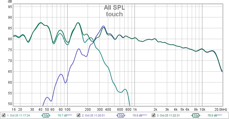

« Reply #80 on: 25 Oct 2021, 06:03 pm »
 I tightened up the triangle with this measurement.

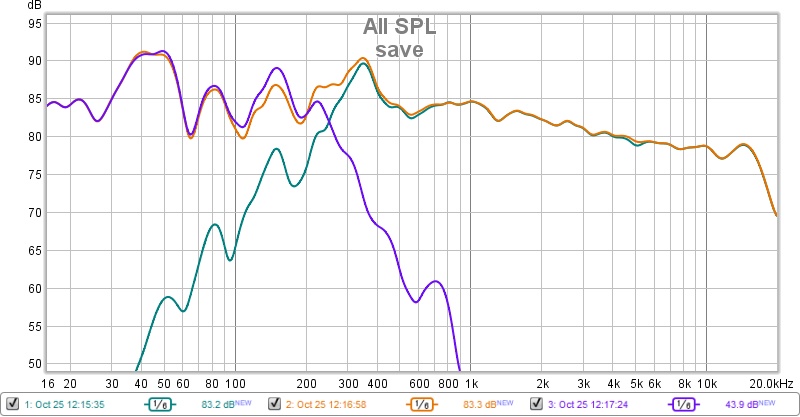

Re: REW

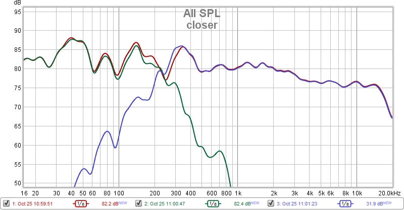

« Reply #81 on: 25 Oct 2021, 06:24 pm »
Crossover points meet if this means anything.

« Reply #82 on: 25 Oct 2021, 06:37 pm »

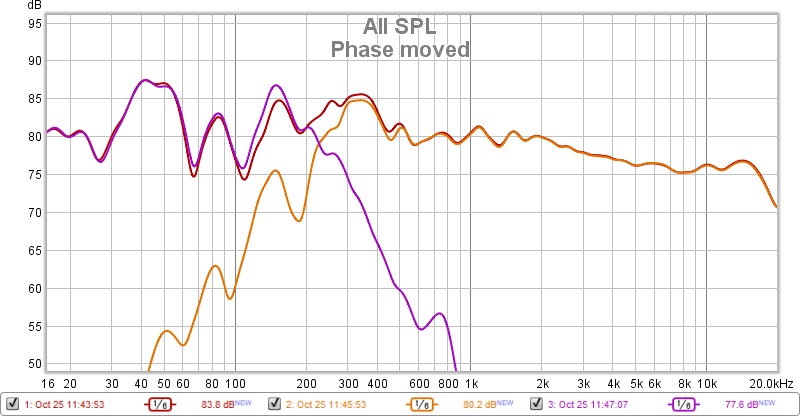

Yes, it means the Wedgie and sub are out of phase with each other. When they are in phase the two will sum at the crossover point bringing the combines spl up 6 dB. That measurement is for one speaker, correct?
mkane
  • Posts: 488
Re: REW
« Reply #83 on: 25 Oct 2021, 06:41 pm »
 Sum at crossover point. And what does that mean, sum?

« Reply #84 on: 25 Oct 2021, 06:49 pm »
 Phase moved. Hole almost plugged. Reading off axis from listening position.

« Reply #85 on: 25 Oct 2021, 07:02 pm »
It means the two signals will combine to increase the output at that point

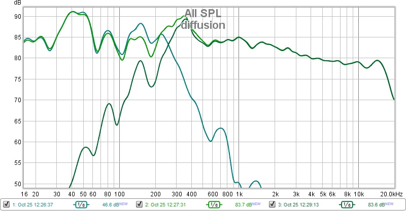

Diffusion added.

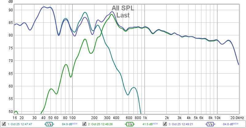

« Reply #88 on: 25 Oct 2021, 07:52 pm »
 One last measurement for toda
  • Posts: 11640
Re: REW
« Reply #89 on: 25 Oct 2021, 08:13 pm »
That's actually not too bad.

« Reply #90 on: 25 Oct 2021, 08:30 pm »
This is looking good now. Do you still have PEQ on or no?

« Reply #91 on: 25 Oct 2021, 08:45 pm »
 PEQ is on. Thanks

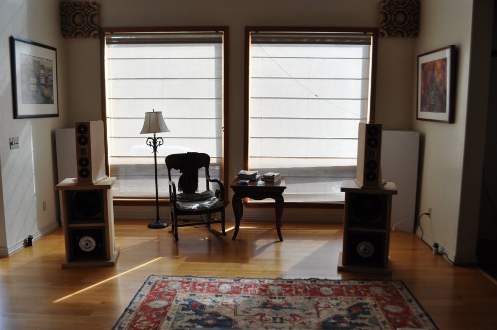

 Re-arranged room. Rug also flipped 90°.

« Reply #92 on: 25 Oct 2021, 09:10 pm »
That really is looking a lot better.  Given the amount of reflective surfaces in the room and the size of the room, you might be about as good as you can get.  How does it sound?  At the end of the day, you want to trust your ears the most.

« Reply #93 on: 25 Oct 2021, 10:06 pm »
 Sounds nice. Much better than before all this nonsense. It's the small things that stand out. Imaging's much better. Speakers have all but disappeared. Bass is much fuller.
  I have some absorption panels I can put here and there next time I take measurements.
The paintings acrylic and have glass covered frames. They can be taken down short term (when the wife's away) if need be.

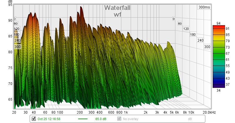

I’d be interested in seeing the results after you install some Acoustic treatments. When I saw your Waterfall plot, it appeared that you have a fairly “Live” Room. I would try to tame it a bit if you can.
Finding a good balance (not “Live”, not too dead) will probably lead to much greater enjoyment, even if you can’t get Ruler Flat FR.

Any absorption will probably help.  Also, that wood floor is possibly one of your biggest problems. Rugs will help.  But the low end stuff (below 200Hz) is unlikely to get much better due to the size and square shape of the room.  But again, it's not too bad now that you've worked things out and I'm glad it sounds better!  Enjoy!

I should learn to read a WF. Below is the latest. I'm going to flip the rug 90° and add a couple throw rugs

Often times, treating the floor and ceiling make a huge difference and it keeps us from having to put really visible treatment up on the walls.  Wood floors are really tough.  I have designed and installed sound systems in a lot of gymnasiums (mostly high school and college stuff) and the floor causes all kinds of problems.

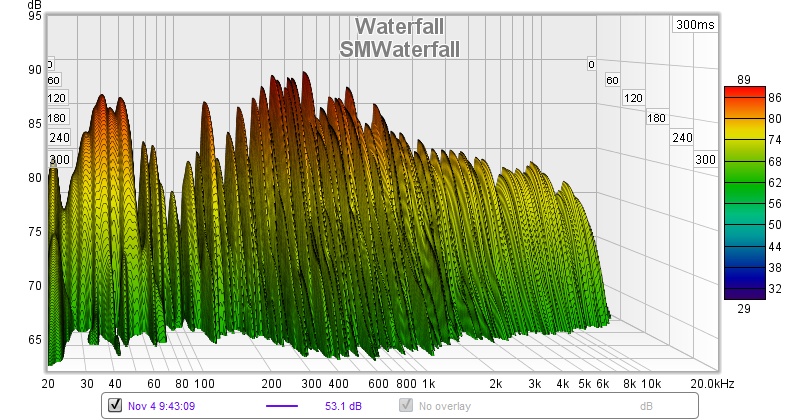

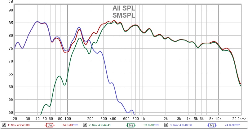

« Reply #99 on: 4 Nov 2021, 05:19 pm »
A few glass framed pic removed, a few acoustic panels in place. These are Super Mini measurements.
