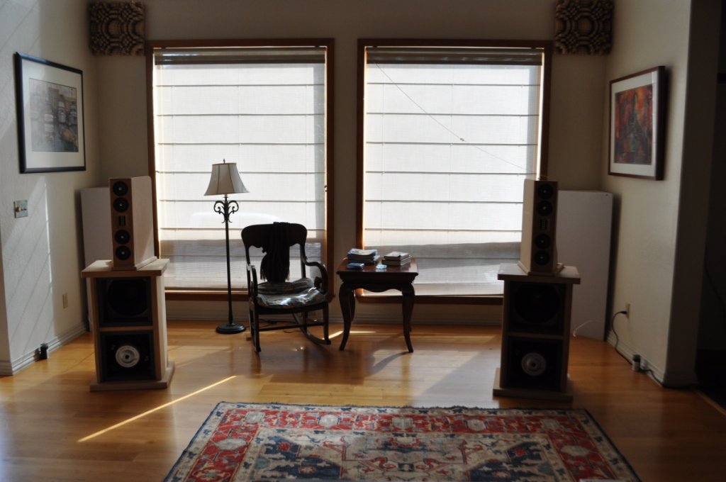

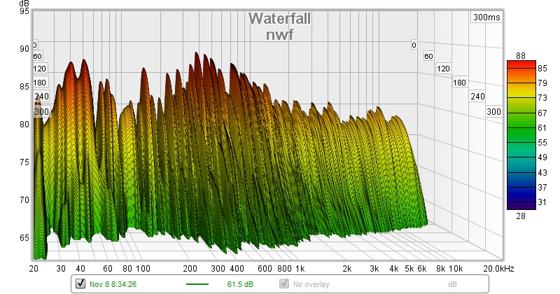

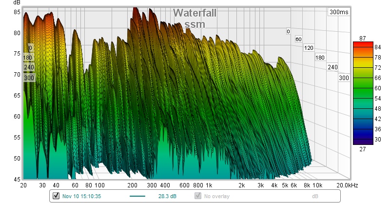

A few glass framed pic removed, a few acoustic panels in place. These are Super Mini measurements.
The waterfall shows that this improved your room significantly.  Even the low end is a lot better.  Can you hear the difference?

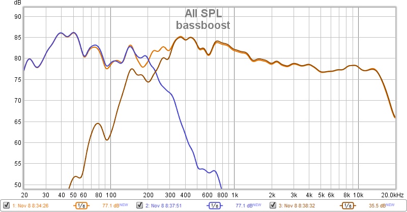

 Here's todays measurements with Super Minis
DannyBadorine
  • Posts: 398
Re: REW
« Reply #106 on: 8 Nov 2021, 08:19 pm »
It continues to look better. What's different today?

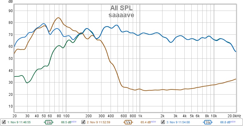

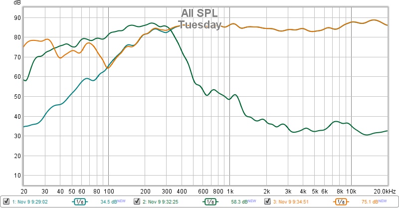

 Well well well. I had the H frames wires incorrectly. No matter what knobs I twist I can't get the crossover any lower. Should it be lower?

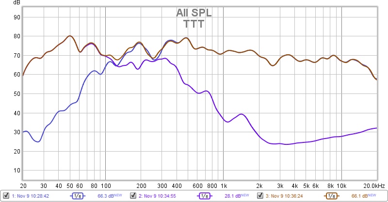

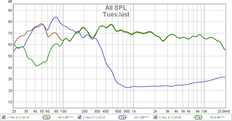

More adjustments. Measurements from listening position.

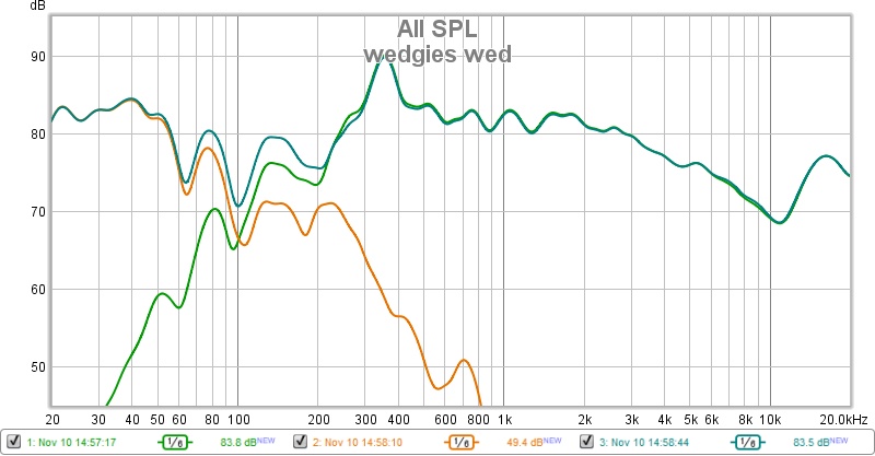

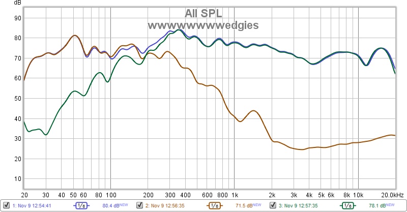

« Reply #112 on: 9 Nov 2021, 09:00 pm »
 Ans the Wedgies.

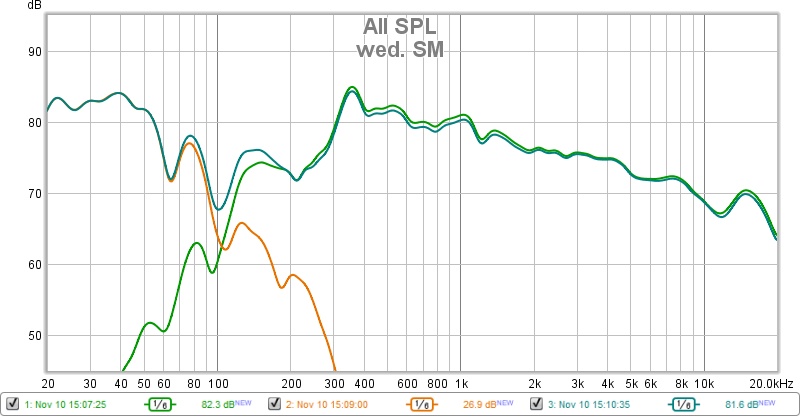

DannyBadorine
  • Posts: 398
Re: REW
« Reply #113 on: 10 Nov 2021, 04:06 am »
Are you talking about the crossover point for the subs or the main speakers? I believe you are using separate crossovers, but I don't remember.  This looks like something is wrong with the phase relationship between the subs and the mains.  They aren't summing correctly.
« Last Edit: 10 Nov 2021, 03:42 pm by DannyBadorine »
DannyBadorine
  • Posts: 398
Re: REW
« Reply #114 on: 10 Nov 2021, 04:11 am »
Wife's just left.
So, if the blue line is the sum of both speakers, you can see that it's lower than the gold line around 60-150Hz.  This means that they are out of phase.  The sum of 2 speakers shouldn't reduce anything.  Try flipping the polarity and see what happens.
mkane
  • Posts: 488
Re: REW
« Reply #115 on: 10 Nov 2021, 02:51 pm »
Thanks for the reply. I'll get on it ASAP
DannyBadorine
  • Posts: 398
Re: REW
« Reply #116 on: 10 Nov 2021, 03:41 pm »
It might not be as simple as just flipping the polarity.  I think that sub has a variable knob that changes the phase/delay of the sub.  You will want to play with that to find the best spot for it that makes the sub and main speakers sum the most.  I would start at it in the "0" position and try just flipping the polarity to see what your measurements are.  If the subs are behind the speakers then I wouldn't use any of the delay/phase knob because theoretically you would need to delay the mains back to the subs.  But it's fine to play with the setting to see what happens.
