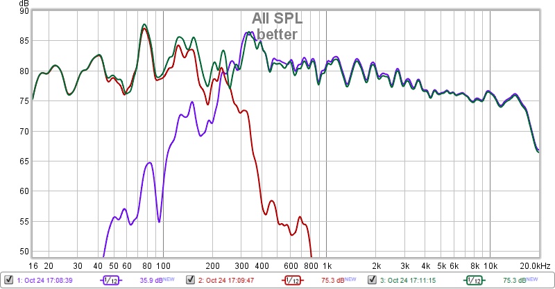

« Reply #62 on: 24 Oct 2021, 11:38 pm »
 Measured from seating position.
  frequency @ 49Hz
gain -8 BW-middle

« Reply #64 on: 25 Oct 2021, 12:15 am »
How's this? I didn't have the PEQ turned on.
mkane
  • Posts: 488
Re: REW

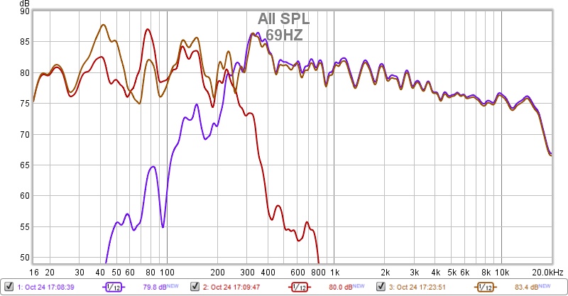

Here's. 69Hz

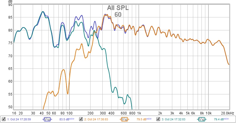

« Reply #67 on: 25 Oct 2021, 12:34 am »
Frequency @ 60Hz.

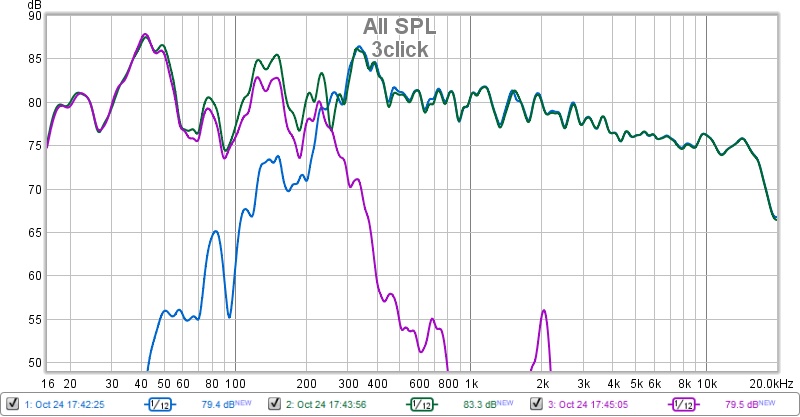

« Reply #68 on: 25 Oct 2021, 12:46 am »
 Three clicks off max frequency.

DannyBadorine
  • Posts: 398

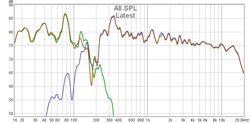

Re: REW
« Reply #70 on: 25 Oct 2021, 04:51 am »
Here's. 69Hz
Just by looking at these, I think 69Hz seems to be the best.  You definitely have some significant room issues going on.  You have nulls at 70Hz, 90Hz, and 200 Hz.  You have modes at 75Hz, 150Hz and 320Hz (which makes sense since they are related........).  But overall, your crossover area seems to be much better and the giant null around 200Hz isn't there anymore so the low midrange should sound much better.  The overall frequency range is flatter.  There is a lot of 40Hz, but it might actually sound cool and fun with movies, etc.  You could use DSP to address these problems by reducing those frequencies that I have mentioned as being room modes along with reducing the 40Hz on the subwoofer.  I might have missed this, but do you have DSP in your system?
Also, did you listen to the system with the different crossover points?  Was there one that you preferred over the others?  Are you able to start hearing the differences in the frequencies that you see on these graphs?

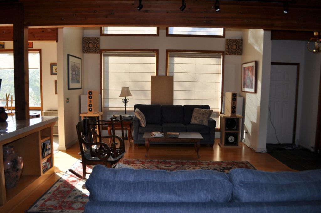

« Reply #75 on: 25 Oct 2021, 04:17 pm »
PEQ off. I enjoy taking measurements and my wife gets it.
Here's our room with the speakers tucked away. There out as far as the table and closer to each other when listening.

« Reply #76 on: 25 Oct 2021, 04:54 pm »
That couch and end table between the speakers is playing havoc with the sound. With those there I wouldn't chase perfection. You won't get it.
I had to move the equipment rack from between the speakers and add diffusion between the speakers and absorption in the corners. I couldn't completely remove the TV from between the speakers so I got an out and down full motion mount like is used above a fireplace. This lets me pull the TV down into position when watching it and push it against the wall and up to the ceiling when listening to music. Not ideal but the best compromise I could come up with.
If you use 1/6 octave smoothing it will make the overall pattern easier to see.
What are you using for amplification?

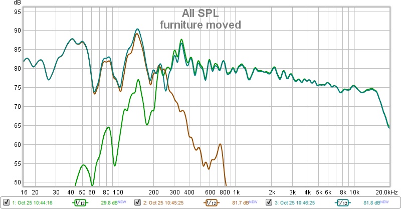

 I can move the couch and the tables. That's not a problem, just give me a few minutes and I'll take some more measurements. :)
mkane
  • Posts: 488
Re: REW

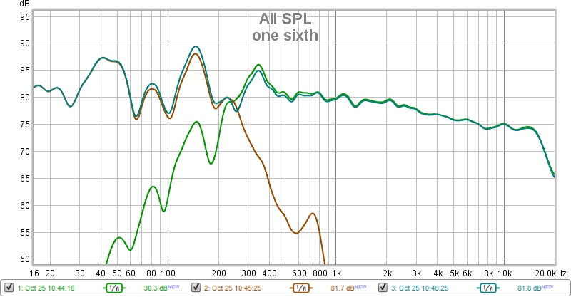

« Reply #78 on: 25 Oct 2021, 05:47 pm »
It's done.
mkane
  • Posts: 488
Re: REW
« Reply #79 on: 25 Oct 2021, 05:54 pm »

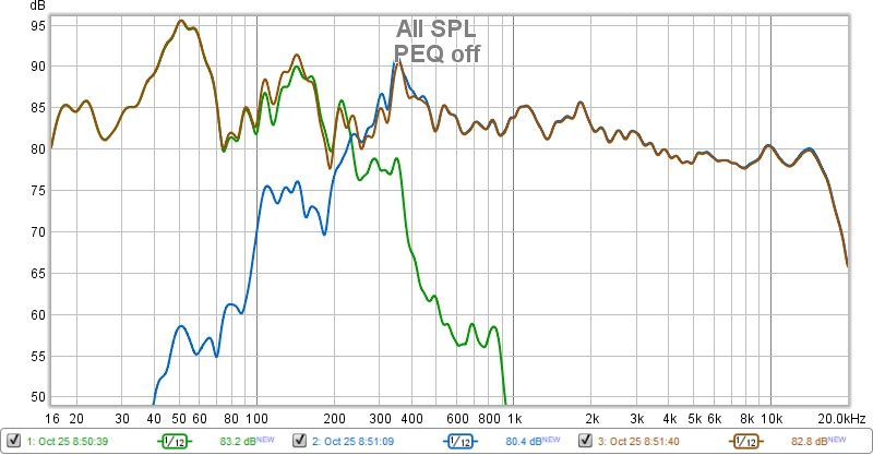

 Here's 1/6 octive. I'm using an Pass Aleph J today.
