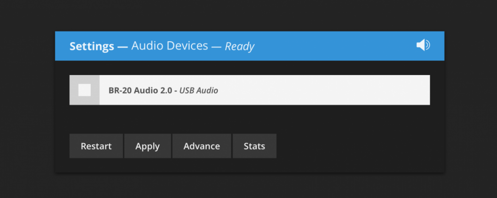

Hello, I would like to ask a few questions about some MM features I cannot understand,
hope anybody could help (thanks in advance!):
1) what is this audio device for?
2) why none of the usb disk command is working? what could be wrong?

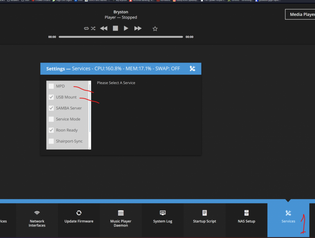

The area you are in is to connect to a network drive.
From Dashboard click services, make sure USB mount and MPD are checked and started.
In order to check MPD, Roon Ready must be off. I am no expert though I use Roon to listen to music.
Samba is only used for connecting to a network drive.
Thanks, but that part is ok as I enabled the services I need. I do not use roon and I do not use network drives, only a 512gb ssd connected via usb and qobuz.
From time to time I connect my MacBook with Audirvana using the usb-b input and it works even if the “BR-20 audio 2.0” device is disabled. So I was wondering what that deivice was intended for

Yah sorry that looks like drive mounting and formatting screen my mistake.
Need a bigger phone screen.   :duh:
Contact [email protected] he handles tech support.
USB 2.0 is also off on mine, but I do have USB Mount enabled want to try the replacement for Manic Moose once its released.

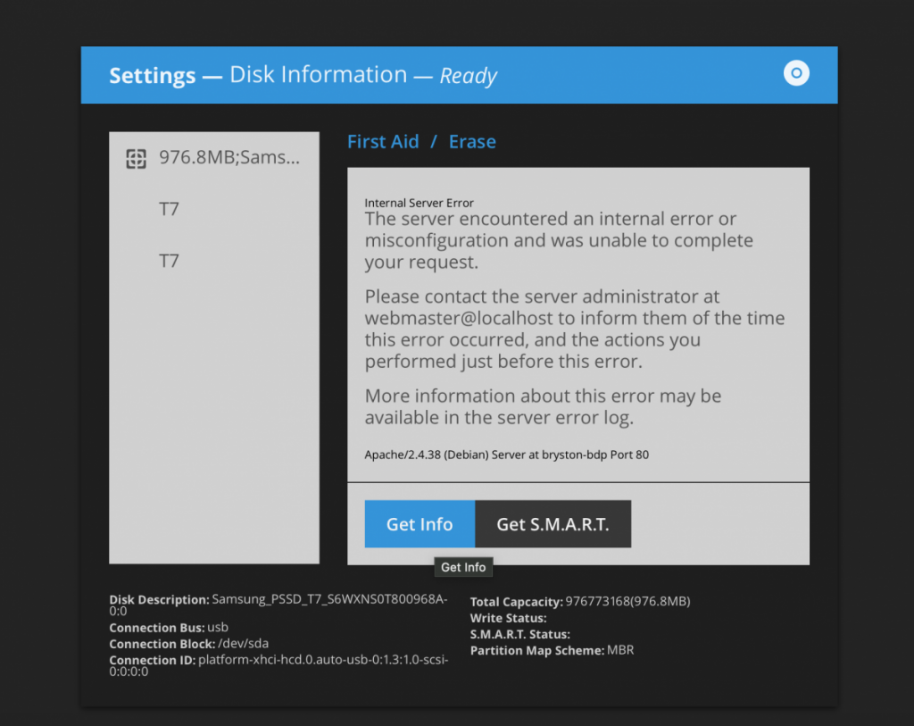

« Reply #686 on: 1 Feb 2024, 09:13 pm »
Thanks, I just did! Given that nobody replied I am assuming I am the only one with such defects.
By the way I found another unexpected behavior in MM:

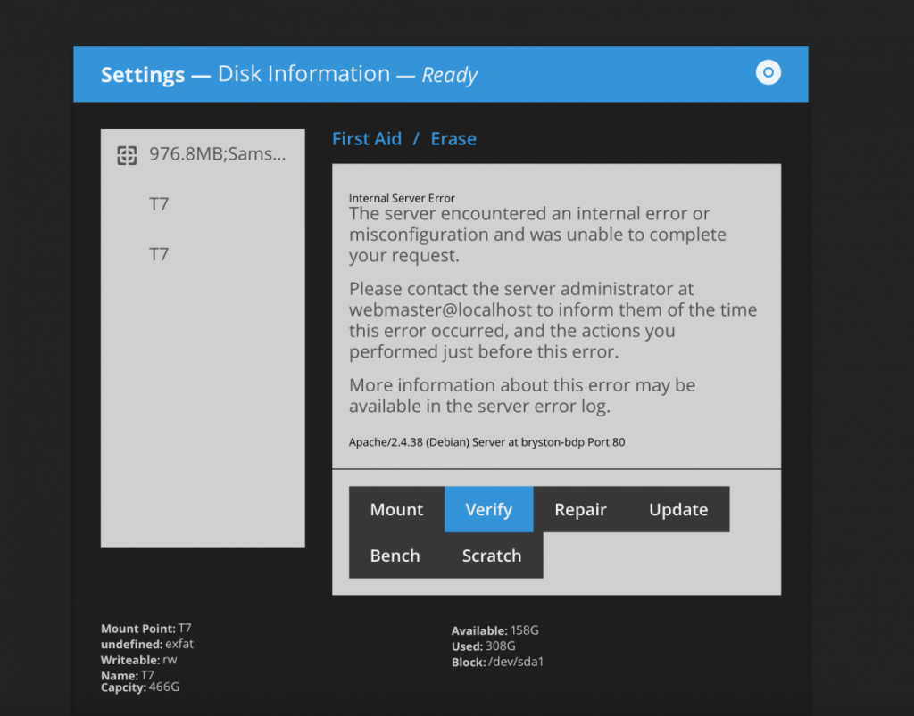

« Reply #687 on: 2 Feb 2024, 05:10 pm »
Update: I am in touch with Adam and he told me that this error is because they are working on the new OS3 so it can be ignored.
I am assuming also the other disk utilities errors can be generated by the fact that MM is way ahead in its sunset.
