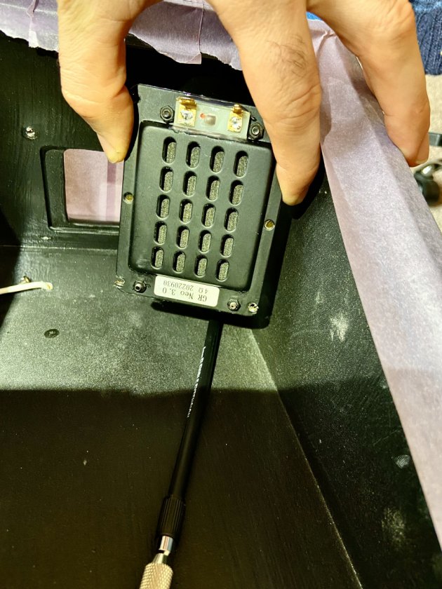

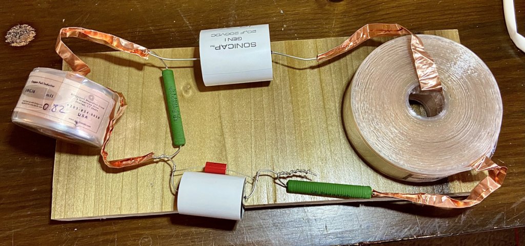

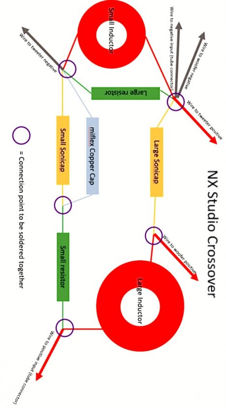

Hey everyone. First time speaker DIY'er here who needs some direction if possible. :D
1) Ive finished the enclosure on the pair of my NX Studios. What a journey so far! Im now on the wiring/crossover stage and would like to know if my crossover layout is correct before soldering this baby
today.
2) Do the tweeters have an up/down orientation? Not sure if they're vertically omnidirectional. Looks way easier to solder if the contacts are on top but it places the label upside down and throws me off lol.
Finally, im unfamiliar with the really tiny red bypass caps. Looks like they're JB JPX bypass caps. Should i consider upgrading these little things in the future? They just stick out as cheesy in the crossover circuit but didnt want to presume upon their sound quality.
Any suggestions or further questions please dont hesitate! Would be greatly appreciated!
today.

Yeah thanks!  That thread definitely answered my 3rd question and then some.  I like the idea of soldering all the leads and connections but just alligator clipping the bypass cap connections to continually try out different bypass caps.  Will definitely consider doing that.
However im still unsure about my first 2 questions.  Whether (1) my crossover layout is right the way i have it pictured, and (2) whether my tweeters are the right way around.
