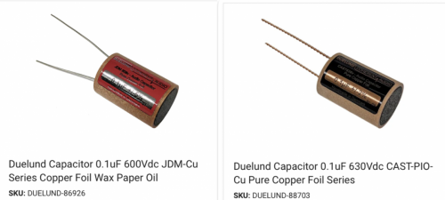

If a person cannot source the Miflex coppers, the Jupiter copper foil 0.1uf caps are a good sub.

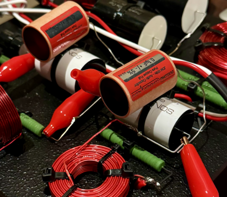

That looks correct. As to the 3 wire or 2 dilemma, I had a stripped part in a single wire for - and connect a + to it. Careful not to gouge the wire doing it though. Here is a pic of my crossover. No judgements here since this was the first one I ever soldered and I'll admit it's sloppy AF but effective. This one is wired up a mirror image to yours, but you'll get the gist of it.
It lives!!!!!!  :D
Thank you for all the help, nlit. You are the man.
