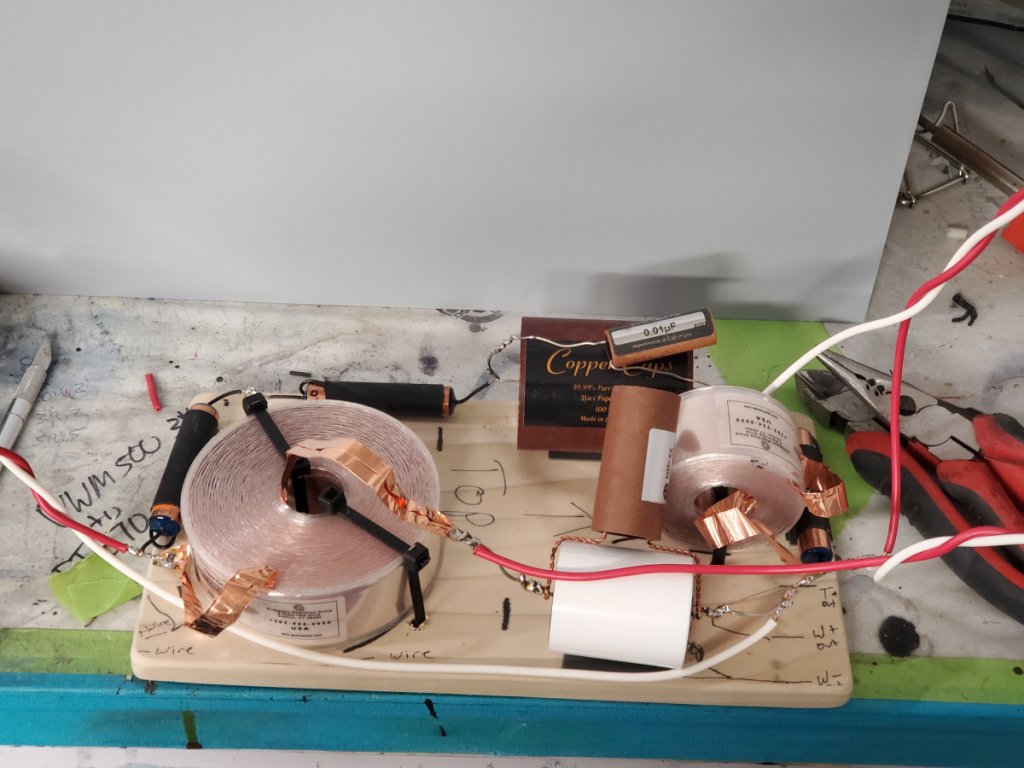

I do have a question because I was using this picture guide to assemble the crossover and this bit that goes to the negative tweeter has me scratching my head:
It looks like the foil is soldered onto the resistor then soldered again onto the capacitor wire leading to the tweeter and the resistor is then wrapped and soldered again onto the capacitor. I'm having trouble emulating this on the board logistically, but is that how it is supposed to be? Kind of like this? The RED in the photo being the solder...
A:
Looking at the diagram that was included with the kit it seems like it would be something simpler like this though:
B:
I can't figure out why the reference photo has the foil soldered to the resistor wire... Is that how it's supposed to be, or is the B photo ok? I'm trying to make sure I do this right before I bungle it up.
Thank you again for all the help.

While it may not be a big deal for the end result, I'd recommend either a triple connection point, or the "B" configuration
YEEEEGZ
  • Posts: 76
Re: NX Studio Crossover Question
« Reply #12 on: 1 Sep 2024, 02:11 am »
Triple connection like this? Just wrap it up like a big burrito?
nlitworld
  • Posts: 2646
« Reply #13 on: 1 Sep 2024, 04:47 am »
Probably easier to connect securely if the resistor butts up directly to the side of the inductor rather than inside like a burrito. That would allow for least amount of solder used and maximum contact of components. You want mechanical connections that are secured with solder rather than the solder being the item to make the connections.
Ok, cool. That makes a lot of sense. Thank you, bro.
