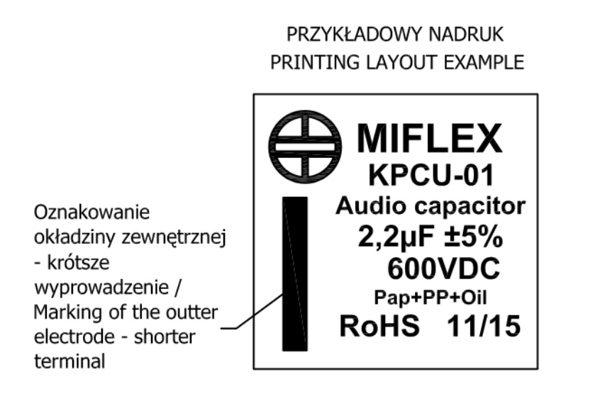

« Reply #31 on: 24 Jan 2025, 08:35 pm »
I was able to source some Miflex .1uf bypass caps........this might seem like a silly questions...........The cap in the attached photo is bipolar, correct?
Hobbsmeerkat
  • Posts: 2741
Re: NX Studio Crossover Question
« Reply #32 on: 24 Jan 2025, 09:37 pm »
correct.
It's very rare to see polarized caps in passive speaker/audio capacitors, they are typically only used in electronics that run on DC current.
Hobbsmeerkat
  • Posts: 2741
« Reply #34 on: 25 Jan 2025, 07:13 pm »
We typically recommend having components following the direction of the text; input before and output after.
But you wont hurt anything if you accidentally get one cap backwards.
