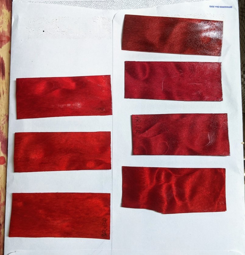

Got the "perfect red" dye in this time.
I also did a little bit of "tone coating" with a small brush to get a better understanding of how this is supposed to look in a more "finished" appearance.
Left: dye & toned lacquer
Right: dye only
While it is definitely more "red" than the "Mahogany Red" it's still not quite the tone I'm looking for, so I've already ordered a bottle of "bright red" which will go thru the same process as above.
I want to do a few different tests as well, where 3 strips will be dyed and toned with the same base color, then strips that are dyed one color but toned with different colors to find which option I think will look best.
So look forward to that in the near future!  :thumb:

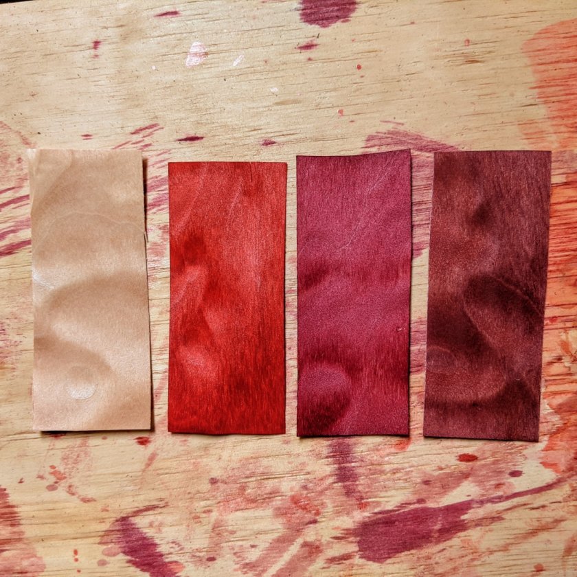

« Reply #26 on: 4 Sep 2020, 12:30 am »
Okay! I got the "Bright Red" dye in finally, & its much closer to what I'm looking for!  :thumb:
Natural, Bright Red, Perfect Red & Mahogany Red.
Next is to tone-coat the samples with different dyes to see if I can find a combo I like most!

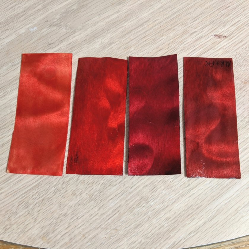

« Reply #27 on: 4 Sep 2020, 12:12 pm »
Heres the same samples with 3 "perfect red" tone coats.
Next will be fresh strips coated with "Bright Red" tone coats.
Ill also do a 3rd test with "Mahogany Red" tone coats after that.

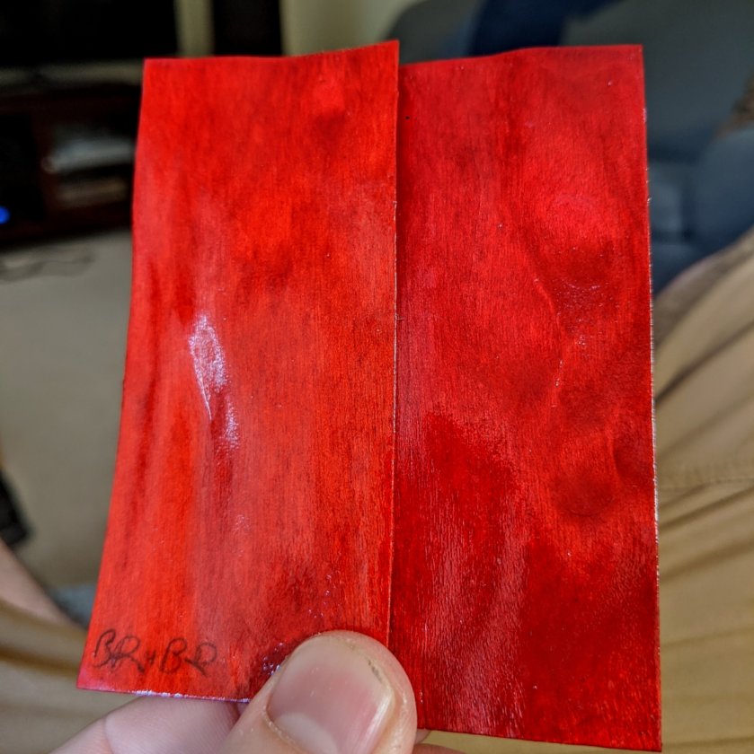

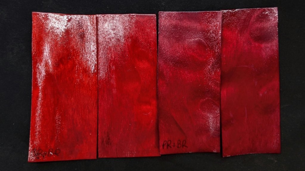

Test batch #2!
Top: 3x Perfect Red coats
Bottom: 4x Bright Red coats
I personally like the Bright Red base with Perfect Red tone coats.
The Bright red only is a little more "warm" red, with the BR+PR is a little more balanced. Imo
My dad seems to like the PR only strip most, but I think it's mostly cuz that strip has more of the curl in it.
This is gunna be a tough pick lol
nrenter
  • Posts: 420
Re: Hobbs NX-Studio Build
« Reply #32 on: 5 Sep 2020, 09:31 pm »
I have my favorite, but I don’t think you’d make a bad choice with any of the middle 4.

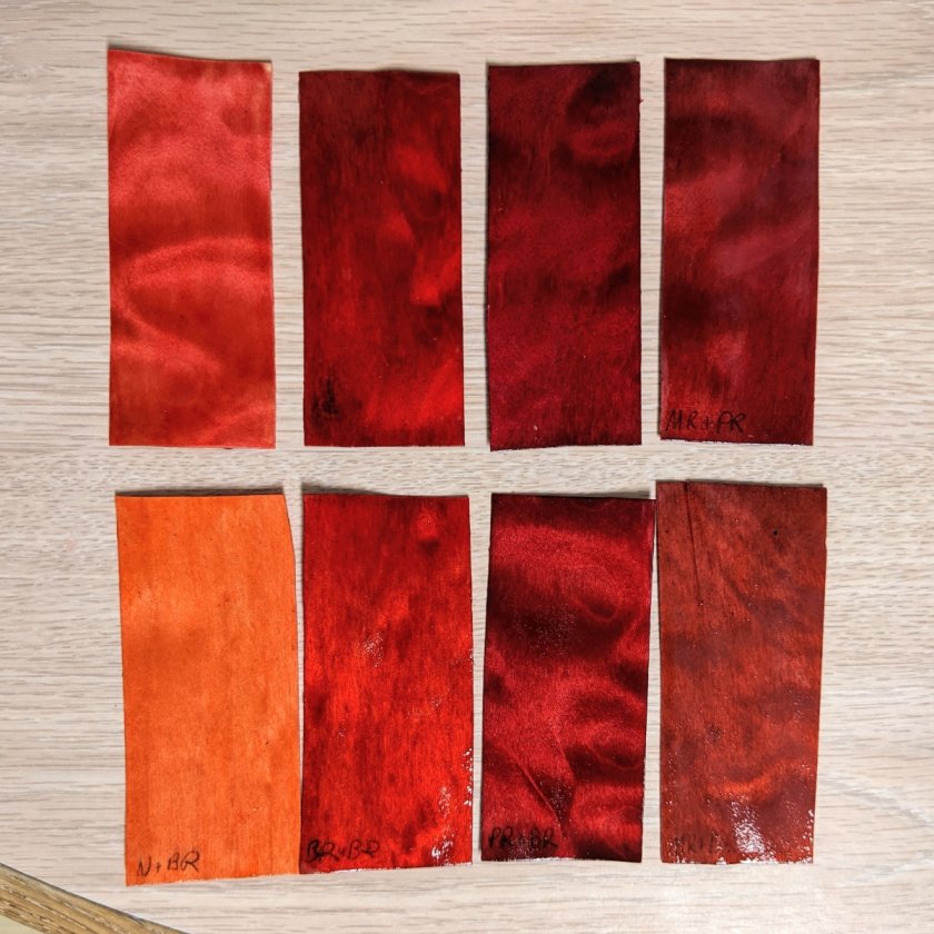

« Reply #34 on: 11 Sep 2020, 11:24 pm »
That is really nice looking for sure, i really do love the look of birdseye maple, esp with really deep wine colors like burgundy.
This is how they appear in my room under the diffused lights rather than using indirect sunlight or a more singular source.
Still leaning towards center-left, tbh, but its a tough choice, cuz center-right looks good too..
I've also wanted to start working on flattening out the veneer, now that I've got the supplies I need, but the weather lately has been absolutely atrocious, with constant rain & ultra-high humidity. Also, with the product I'm using to flatten the veneer, this process really needs to be done outside for adequate ventilation.
So hopefully things will clear up soon so I can finally get started..

« Reply #35 on: 12 Sep 2020, 01:40 am »
Not sure if it’s Just the variation of grain pattern but center right has some really cool depth.
Hobbsmeerkat
  • Posts: 2741
« Reply #36 on: 12 Sep 2020, 02:19 am »
It's definitely a variation in grain pattern.
For these test strips, i used the edges which have areas that are far less wavy/textured than the areas in the center I plan to use for the speakers themselves.
hawkeyejw
« Reply #37 on: 12 Sep 2020, 07:11 pm »
Got it. I think any of them applied over the whole speaker will look great.

Hobbsmeerkat
  • Posts: 2741
« Reply #39 on: 16 Sep 2020, 02:27 am »
Okay, I think I've found the color Im going to go with!
It's actually a hybrid of roughly 50/50 Bright & Perfect red for dye & 65/35 for tone coats.
It's the bottom-right sample.
Its got plenty of depth, without being burgundy or too bright.. :thumb:
