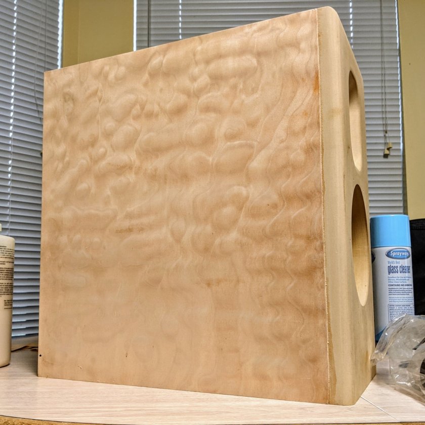

Thats exactly what I'm using, but quilted maple is proving to be difficult to work with.

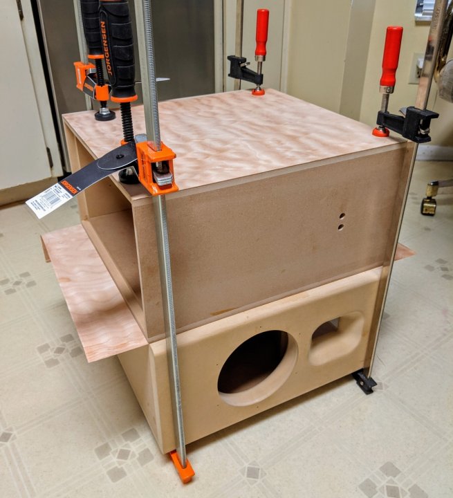

Yeah that's basically what I did with the first speaker.
Tho I'm not using heat lock adhesive, I'm just using their standard veneer glue which requires pressure for the first few hours, with pretty decent results, but it really takes some doing to get the veneer flat, & there's still a small bit of ripple in the middle, but its not noticable thankfully..
Pressing out the ripples really takes some doing. Checking on the veneer this evening, it's looking better, but its a slow process..
I need to find a better means of flattening than plywood 2x2 rods & clamps. But I'll get there! lol
I know nowhere near as good as real purpose-built tools, but maybe an aluminum or steel plate instead of plywood?  Wandering down another hobby/tangent, a 45lb old school deep dish machined cast iron weight plate or a calibrated 20kg or 25kg steel weightlifting/powerlifting disc at 450mm diameter might be just big enough to do the job that might be handy to get if you don't have a lot of manufacturing or fabrication shops around where you live?  A pair of plates and some clamps could make for a nice big flat press?

Hobbs:
Use multiple  clamping cauls to evenly spread the veneer clamping pressure.
A  Caul is a simply a  slightly tapered  clamp block that redistributes the clamp pressure from the clamped edge to the center of the panel.
Google ‘clamping  cauls’  for creation and use  instructions.
If you are using an intermediate  melamine veneer pressure plate, the absolute caul quality does not matter nearly as much as for a typical full edge tabletop glue up .

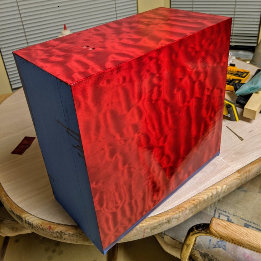

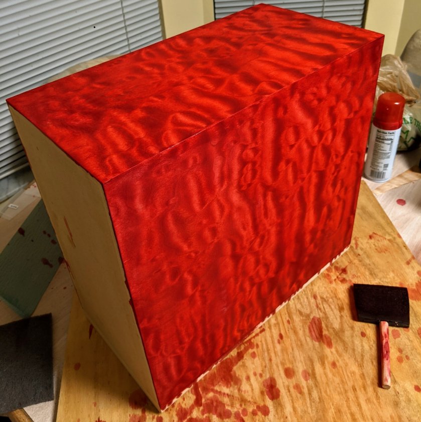

I've been making good progress on these puppies!
All the veneer is on, & the first speaker is dyed!  :thumb:
The dye is still wet, so the colors are still vibrant, it'll fade more purple/, but once I start adding the tone coats it'll come back really strong. Tomorrow I'll pick up some filler to hide the step/edge of the veneer.
Feels good to be making progress again.  :thumb:

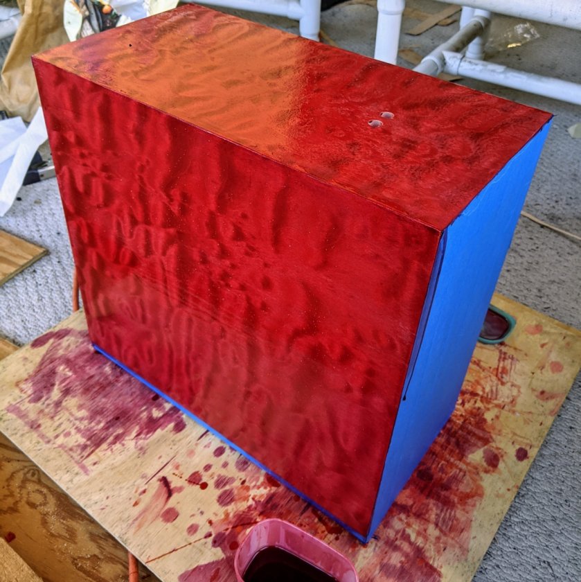

First tone coat is on!  :thumb:
Other cabinet is receiving some edge glue-ups where they didnt stick quite right. It should be ready for its first tone coat in a couple hours.

« Reply #96 on: 8 Dec 2020, 11:13 pm »
That looks like it's still wet!  Looking good tho...
Exactly! I need to give this one a day for the lacquer to cure before sanding & another coat. After that all remaining coats will be clear coats. Hopefully over the weekend I can coat the 2nd speaker, but it needs to be a day when im off so i can take advantage of the warmer weather, otherwise I risk the lacquer turning cloudy.
Here's how it's looking now.
I've also started working on the grills for the top, both have been primed, & one has been painted, ready for applying the grill cloth.
