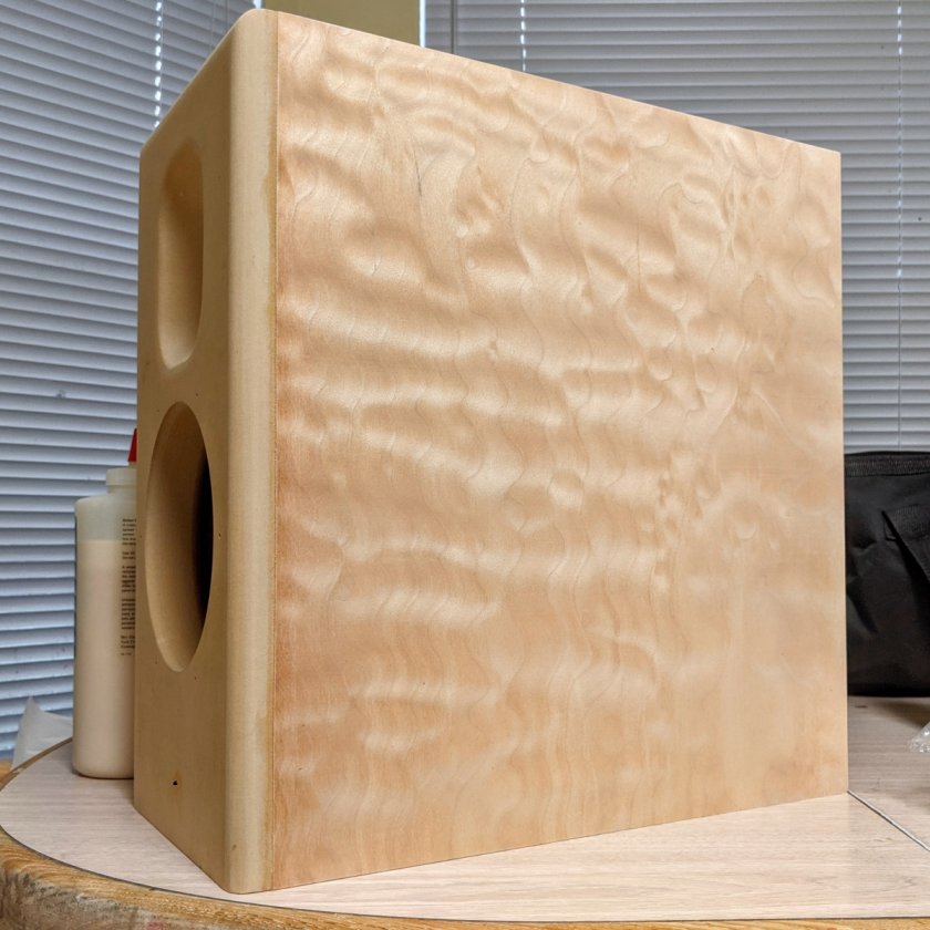

Update!
Got the flattened veneer glued to one speaker!
Gotta start flattening the 2nd batch of veneer next!  :thumb:

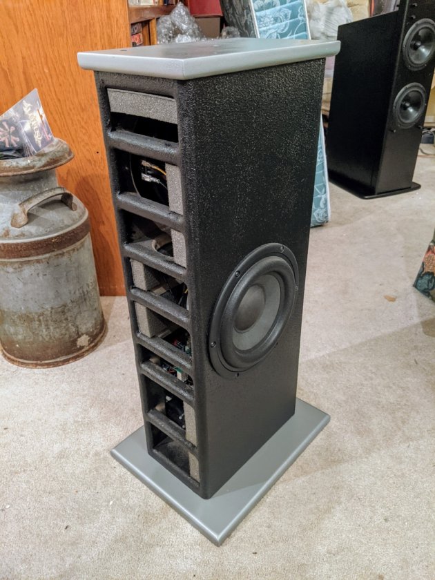

My servo sub stands arrived from Danny today!  :thumb:
(Yes that's an X-Statik in the background, the pair arrived today also~ :P )

Ive listened to them for about an hour or so, with a single servo sub stand in the middle.
But so far they sound great! The mids are really clear & spacious, and since they dont play down very low, they offer plenty of detail.
That said, it does lack a bit of clarity and depth in the treble that my X-LS have, so I'm guessing its still the stock crossover.
But there are songs that sound better on these than my X-LS
The subs are really fast with lots of detail and easily hit into the 20s  without the boom of my 12" Rythmik, I'm definitely excited to hear them running as a pair in the future tho! should help with the low end extension a fair bit. The lowest notes in Boz Scaggs "Thanks to You" are just a little thin, so the 2nd tower should help.
I've got their placement about 5' into the room, crossing just behind me, but I still need to dial in the sub a bit more. Depending on how I'm sitting the bass is either full or drops out. It's likely playing up too high, causing cancellations at the listening position.

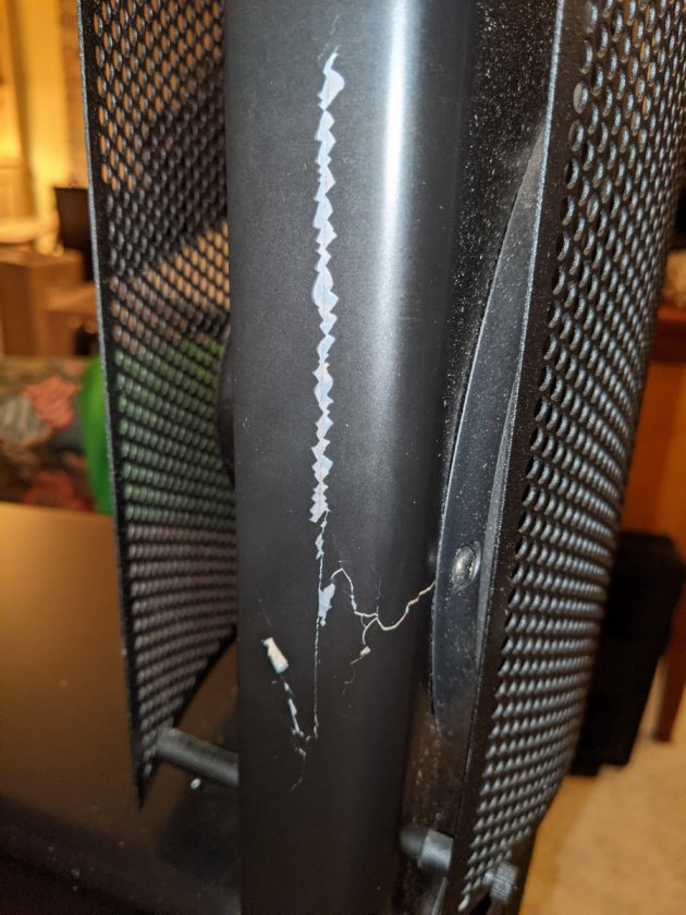

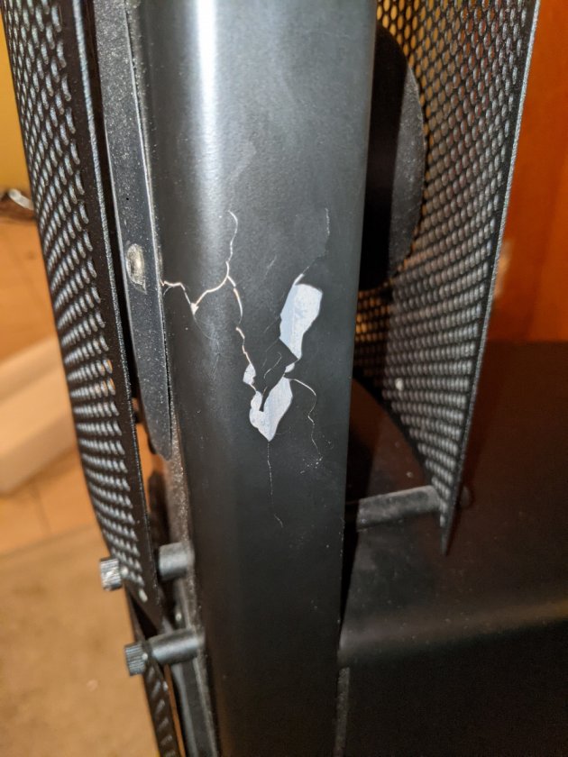

Unfortunately one of the X-statiks was damaged in shipping, but I'm working with the seller on filing an insurance claim.  I've sent a message to Danny to ask about possible repairs. Luckily its not catastrophic. but still a bummer.  :(

« Reply #75 on: 1 Dec 2020, 07:20 pm »
Having owned and upgraded several X-series speakers I could easily identify what you're talking about.  It's kind of a graininess.  Sonicaps are much cleaner sounding.
Here's a shot of my upgraded X-Statik crossover with Sonic Platinums and Gen 2 as bypasses.
My Statiks also had some flexing of the open baffle section during shipping.  Fortunately the Moho veneer does a good job of hiding it.
BTW, if your 12" sub is boomy then it's not dialed in right.  Or it's in a bad spot in your room.  There should be no boom unless it's in the recording.
Yeah thats likely the case, i dunno if grainy is quite the right word, but but there's definitely a softness or veiled aspect to the sound.
My XLS just has the base kit with tube connectors, but i know it's already a head of the game in terms of overall quality. So ill probably order the sonicaps as upgrades, or go all out and do point to point wiring with the bigger inductors.
Hah thats interesting that your crack pattern is nearly identical to my own. At least yours does hide it really well.
I may do it "right" & replace the whole front baffle, or i may go the easier route and just sand it down and fill & seal in the problem spots then paint to match.
But I know if/when it gets shipped in the future, another hit like that will likely destroy it totally.. unless i can come up with an easy way to reinforce it & still remain hidden under a fresh coat of filler & paint.. or reinforce it before shipping..
It's no longer boomy since I've gotten it dialed in, thankfully. That said, it still loads the room differently than the OB servo stands, which still do a great job once they're dialed in.
After I get that room a cleaned up, (cuz its a total wreck now) I want to get both stands up and playing, cuz there's not quite enough room at the moment for both, unless I move the XStatiks aside and put my X-LS on the stands.

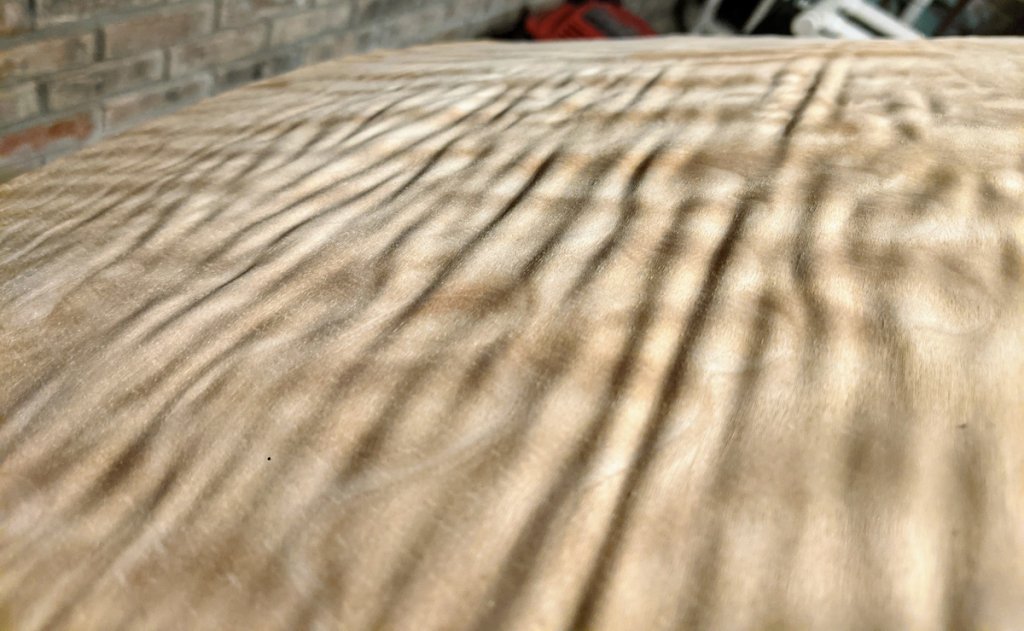

Seems like it's impossible to avoid getting these really tight ripples in my veneer... But hopefully I can get this figured out..
(The joys of going with raw veneer rather than treated paper-back)
 :roll:

I'm just tossing this out there - I don't know if it would work or not.  What about using a hot iron and using steam to flatten those pieces?
Hobbsmeerkat
  • Posts: 2741
Re: Hobbs NX-Studio Build
« Reply #79 on: 4 Dec 2020, 03:29 pm »
I have tried that before, but it didnt really make much difference, sadly. But I'm sure i can get it worked out its just gonna take some time.. I've made progress since last night thankfully, but not ideal.
Steam isn't recommended tho, since it will cause the veneer to swell.
