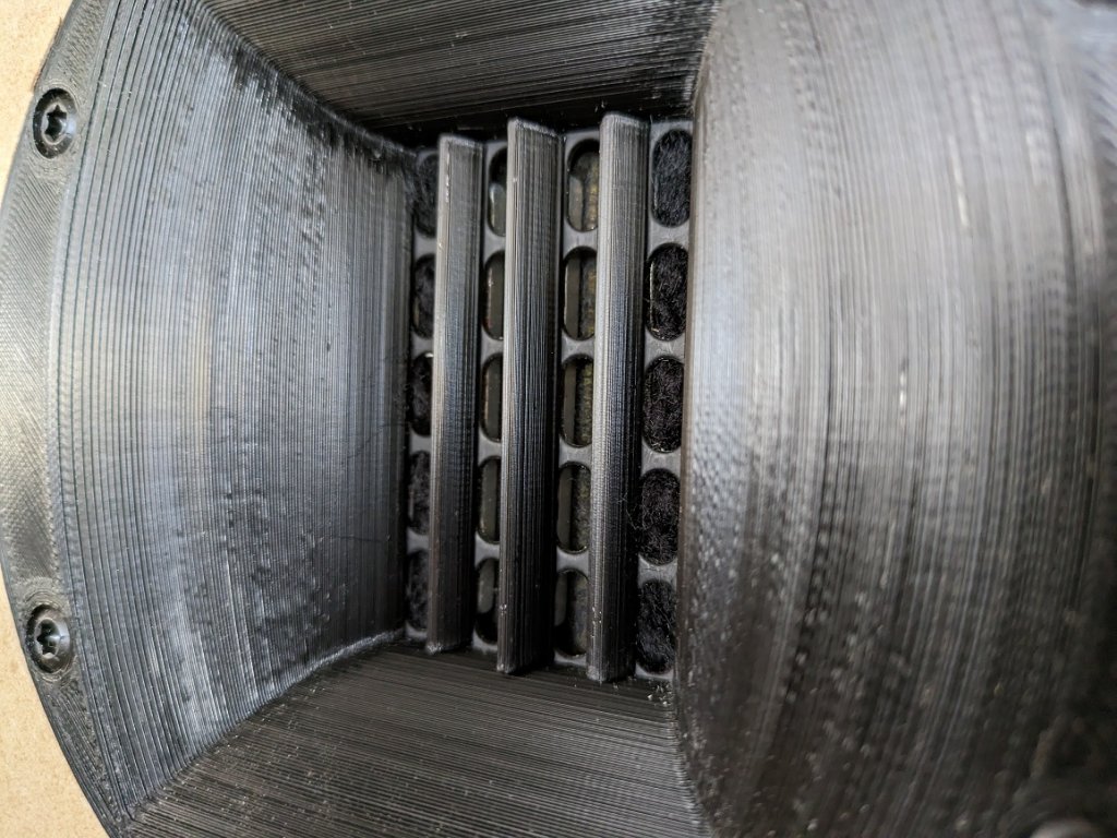

Been doing some more testing with Neo 3 drivers in waveguides (working within the footprint of the old BG faceplates) and I remembered this dusty old thread, namely the rods shown on page 2 to see what differences there might vs the bare faceplate.
so I printed some in different sizes. (half-circle, medium cone and tall cone)

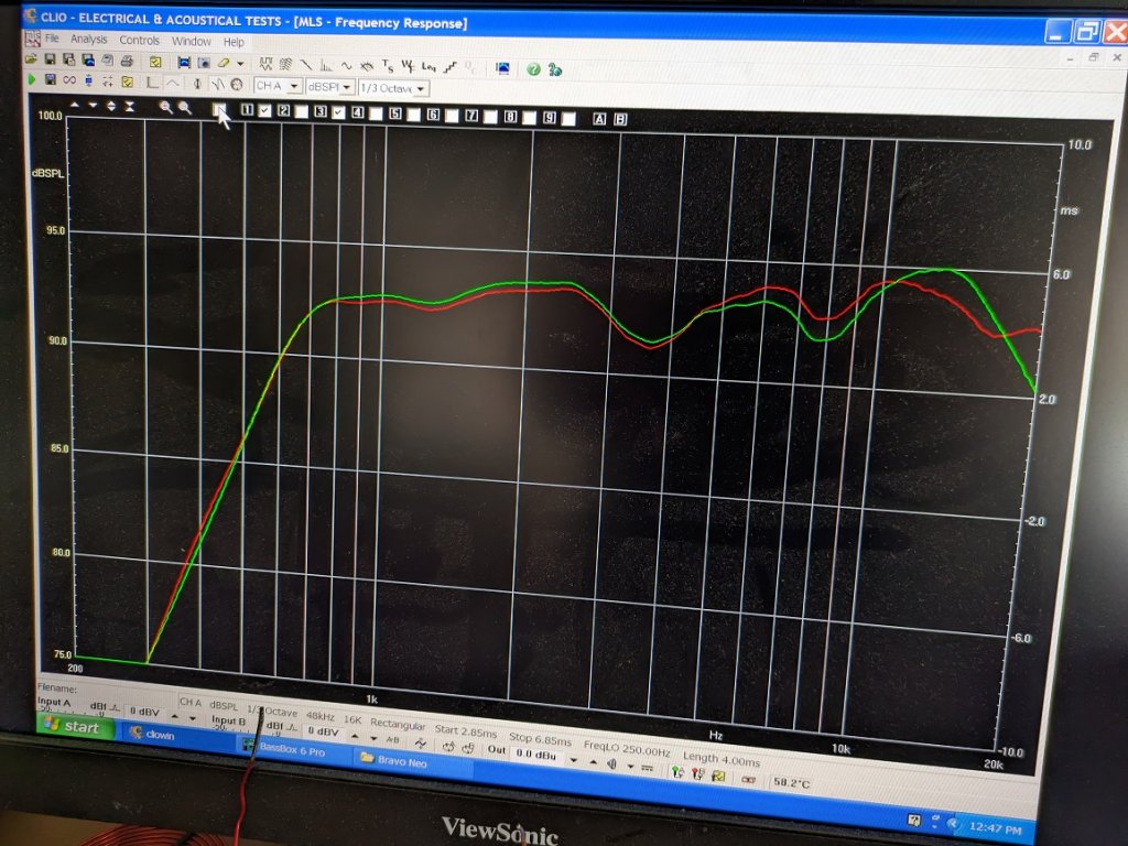

The results:
Red: With rods installed (same as picture, tall on the inside, medium on the outsides)
Green: No Rods
Most other variations in the response fell somewhere between the two above measurements.
The tweeter had a baffle-step compensation network on it, but no capacitor.
Fairly small differences, mainly above 5Khz, with a little smoother curve, and better top end extension above ~17Khz
Not quite as smooth as the 3" deep standalone waveguide I did some time ago, but, it's also a lot smaller.
