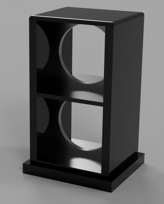

This is the same with outside glossy black.
Sooner or later I will also add the No Rez and the drivers.

Dang, Thats a gorgeous render!  :o
I'll definitely need to look into Fusion360 here soon then!

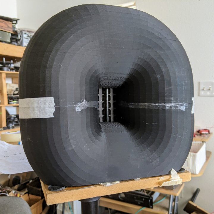

Reviving this thread to show off a wild idea I had & got to test today. :P
I was inspired after watching some videos by Joseph Crowe
https://youtube.com/c/JosephCrowesDIYSpeakerBuilding
3" deep horn-loaded GRNeo 3 with back cup.
The shape is rather impractical in this form, but the response is quite impressive.
I tested it without the cup, but it was a pretty rough response until about 7-8KHz
Going to shoot for a slightly smaller 2.5" horn to better match the voice coil of the 8" 200 NQ.
Might also make a 1.5" version to see how the response changes.

Dang, that’s impressive. How low does the NEO 3 normally extend without the waveguide?
Depends on the depth of the back cup and how its mounted. Flush mounting using the BG or similar faceplate, realistically its crossover point will need to be in the 2-4Khz.
With the NX waveguide, crossover can be as low as 1200-1500Hz.
With the more horn-shaped waveguide, we can probably push them as low as 700-900Hz.

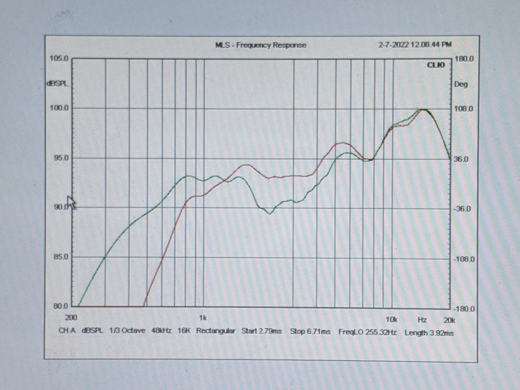

Do you have a without waveguide plot for comparison ?
Thanks much.
Here's what it looks like in a flat faceplate: in an OB-7 cabinet.
Red: deep back cup
Green: open back
Here's a shallow 3/4" waveguide:
Here's the measured response of an MDF version of that same 3" horn I shared Earlier.
Red is raw driver
Yellow is with a simple network on it.

Thanks.  That is a very impressive improvement.
Wonder if it would extend the NEO8 range lower.

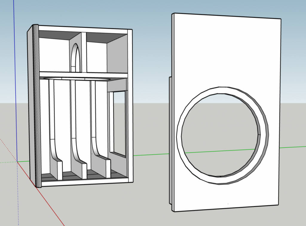

Ok, so years later I keep wondering how a side-opened wave guide/rear opening would sound compared with the top-opened implementation of the Studio.
Maybe a better way of asking it is how would the Studio change/not change if the tweeter opened to the side rather than the top?
Separately, I've seen something similar to Hobb's sketch below from a manufacturer or two, but haven't heard any of them.
[edited to remove repeated words ;-)]

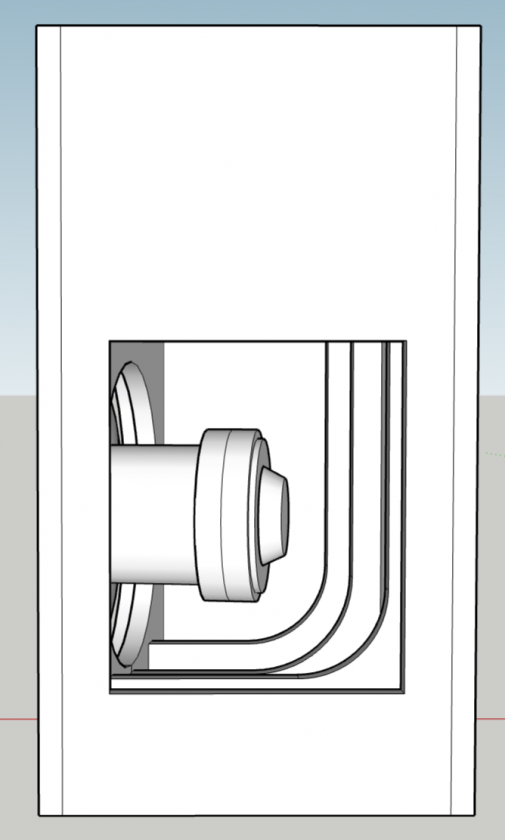

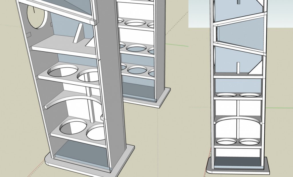

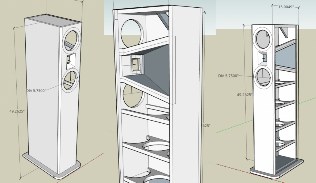

Just so i don't get sidetracked on my Neo 3 thread, I'm gunna have a separate thread for brainstorming speakers ideas, loosely around Danny's design themes & current drivers.
This is all about having fun, so feel free to make suggestions, and other interesting design ideas, no matter how crazy or silly they may end up being! :P
Here's where the concept for this thread started:
An MTM derived concept of the NX Studio with a side-opened wave guide
And in the desire to create a matching sealed Servo sub it has gone thru a couple ideas. Before settling on a more wedge shape reminecent of the NX-Otica, allowing for mounting of the plate amp
When I get home tonight, I share the standalone MTM and Center channels I worked on yesterday.
