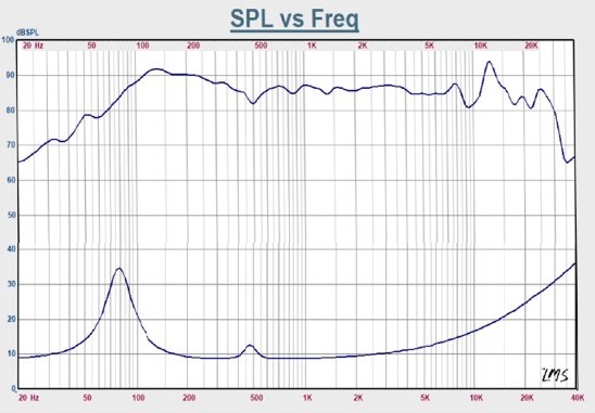

Hi Peter,
I have no listened the Lii F15 but there is no complaint on it on the Decware site, they said it does not have the usual shout on the 2-6kHz range, this is something new in big cones a great advance. There are several big cones drivers from AN that have no response under 100Hz, you should avoid these speakers.
https://commonsenseaudio.com/an12classicspecs.jpg
https://commonsenseaudio.com/an15classicalnicospecs.jpg
bigger drivers is the way to go for classical music.
No to all classical repertoire, only to large orchestral music or heavy rock, a string quartet could benefit from a small 6'' driver due the musical treble content, the Alpair 7 can reach 30kHz and fall out at 40kHz but not efficient only 86dB:
but wondering whether you feel it can deliver with the same level of quality as a small driver can, or it is more a matter of implementation?
My personal view are that 12/15'' have great sound quality under 400Hz or so and 6'' and smaller drivers have great quality above 800Hz, that said maybe could be that drivers between 8/10 '' are the middle way that can run both, mine are this 10'' why it appear a nice offer at the time. Implementation is always important but personally I think that in small drivers it is more critical unless they run OB.
https://commonsenseaudio.com/an10classicalnicospecs.jpg
If a smaller driver is sufficient for my needs is it still worth to pursue a larger one?
I cant really say, it was already difficult to choose for myself, but its clear that you have 3 options:
-Small cones 6'' and smaller
- Mid cones 8 to 10''
- Big cones 12 and 15''
