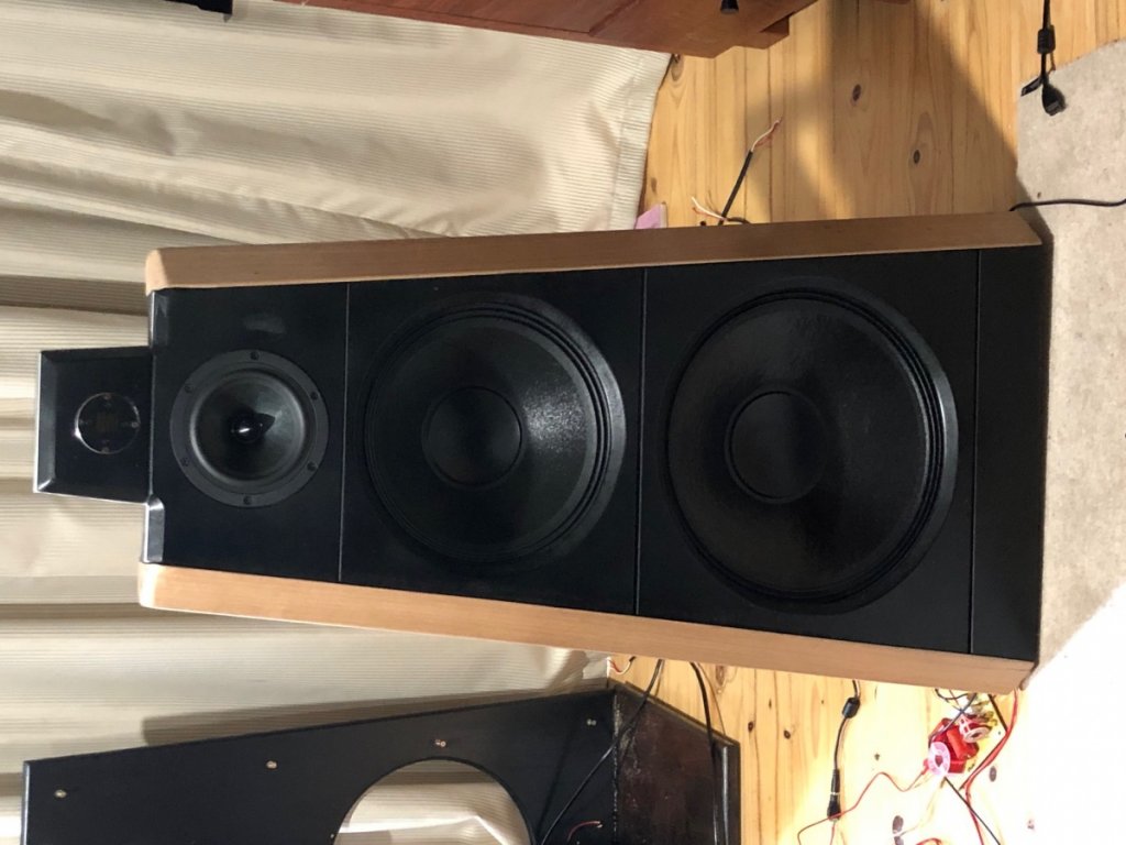

Sorry for the image rotation - no idea why it only happens here.

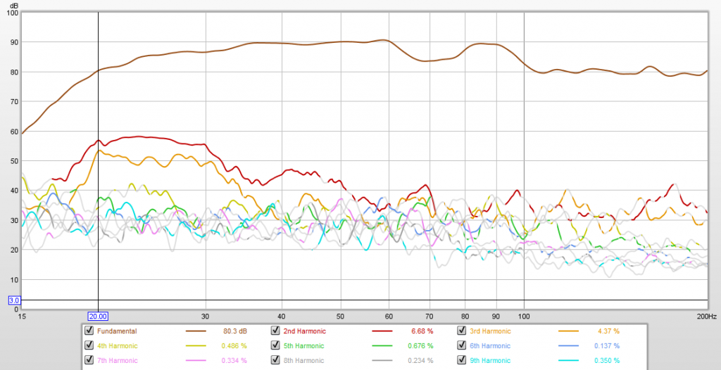

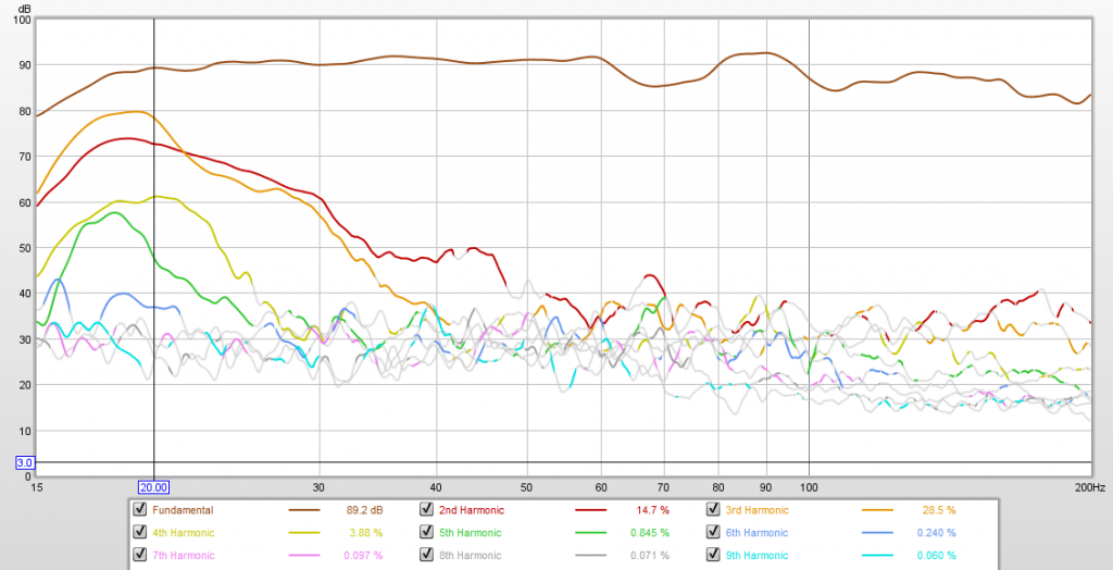

Hi gils, in principle I agree but at very low frequencies I have two listening observations:
1) The bass, even with such high boost, is tight, transparent and effortless. Being free of resonance it still has that amazing open baffle feel. Low double bass notes sound like the instrument is in front of you.
2) Distortion below 50Hz is hard to hear. Even synthetically created distortion to 10% is much harder for me to discern that at higher frequencies.
I have A/B listened with various filters and slopes and like the higher boost more.
What I do observe is that the poles and zeros of the bass slope correction filters should be outside the bass speakers functional frequency band to reduce the phase impact.
Below are REW measurements that show the distortion effect of the greater boost. I can hear the impact of the flatter response - I can't hear the extra distortion - mostly listening to jazz and rock.
Bass Boost Distortion +15dB max (15-200Hz)
Bass Boost Distortion +10dB max (15-200Hz)

Pictured below is one of my test set-ups from last year where I experimented with a variable U frame using piano hinges and sides trimmed to various depths from 250mm to 50mm. None of these combinations appealed. The effect of the sides was audible and the main measurement impacted was impulse response.

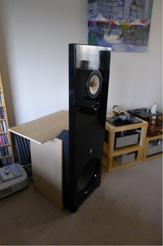

I too used temporary side baffles to create a U frame. With the baffle over the full height of the speaker, about 8"deep. I did not like it as some of that lovely OB sound was gone. Now I run with a deeper U baffle but only behind the bass driver. Its 18" (45cm) deep. It has no top but I may experiment with that later.
Here it is during my experimental lash up. NOTE, I abandoned the lid

Thanks for the "work in progress" photo.

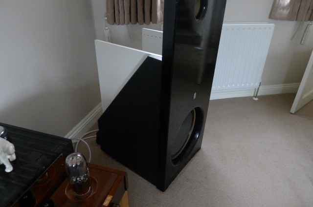

In case you missed it elsewhere here is a slightly more refines version of te side baffles. I have also pulled the speakers further out from the wall.
