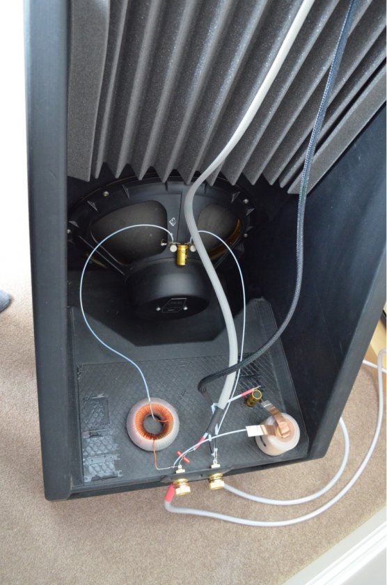

I have been reflecting on my 15" bass drivers which are vintage alnico Altec 416B.
They are what is know as VOTT, meaning 'Voice of the Theatre', and spent their formative years in a theatre or cinema so I guess they are well able to pump out the low frequencies  :wink:
Up till now, running in unison with the mid range and tweeter fed by a single amp, they deliver an acceptable level of bass for me, but interestingly I have never really seen the cones move even on heavy bass notes. I am therefore guessing with a separate amp and DSP I may be able to release the genie from the bottle.

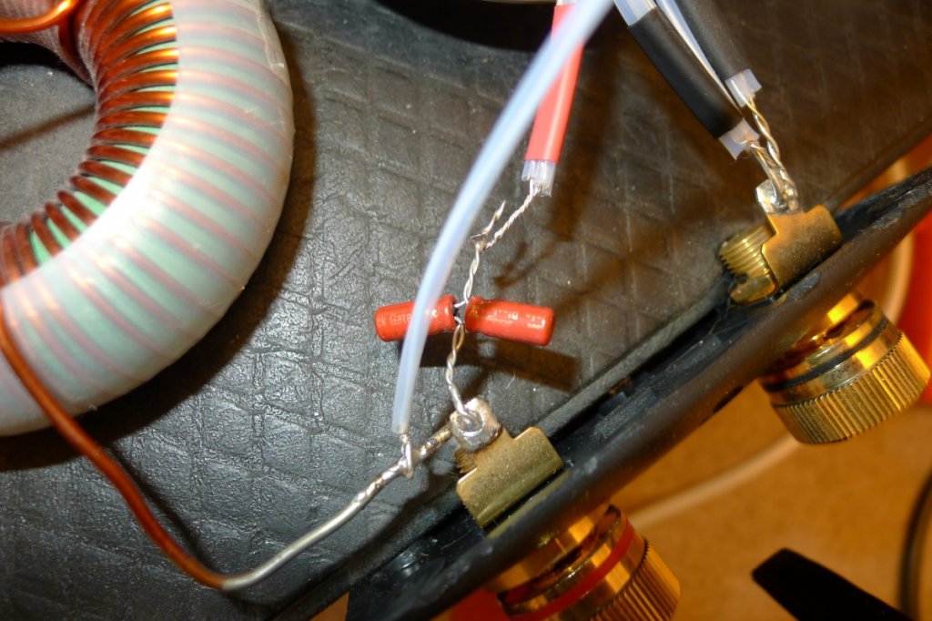

Simple question I thought I would slip in here.  :)
The picture shows my simple high pass filter on the tweeter. I believe twinning up capacitors like this is done to 'neutralise' magnetic fields, but what is the configuration called. I did know but have forgotten  :duh:

Hello Bumpy,
very good job but the Altec 416 is made for horn speakers, his QTS too low does not allow him to produce bass in open cabinet, he find you a speaker 15 "or 18" low blow (50 €) with a small engine, much like the 15A eminence at high QTS.
best regards Gilles
