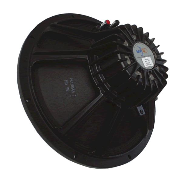

https://www.lean-business.co.uk/eshop/faitalpro-15pr400-8ohm-15-400watt-pa-speaker-p-1381.html
Study the Troels Graveson site for his OBL-11 and OBL-15 designs. The OBL-15 uses the 15PF400 driver and the crossover components are listed.
