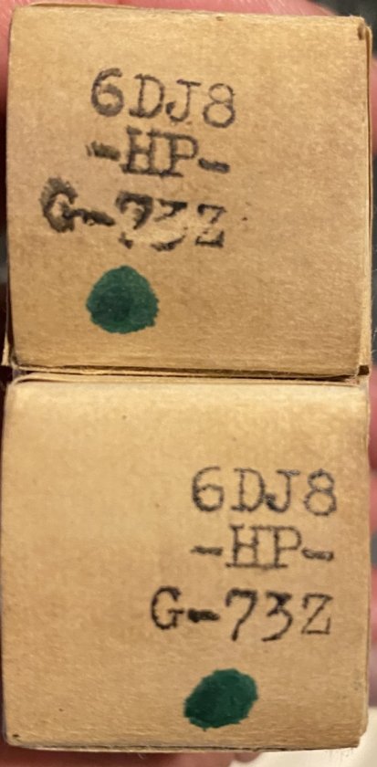

We provide JJ ECC88's (equivalent to 6922, 7308, 6dj8). Considering ECC88 (Euro designation), 6dj8, 7dj8, 6922 and 7308 to be equivalent and all work in the unit:
Telefunken: VERY Detailed and fast sounding!
Siemens: Also very detailed and resolving.
Amperex: Resolving and very balanced.
Brimar or Mullard: British sound, a bit more warm and relaxed.
There are many more, but these are the ones that I have experience with and that pretty much cover the tonal spectrum.
The REAL expert is Andy at Vintage Tube Electronics: https://vintagetubeelectronics.com/
Note that Andy is old school and you are more likely to get him on the phone than get a speedy email reply. He is also very busy these days, but he is our go-to for good NOS tubes.
Dan

+1 Dan is spot on with the those recommendations. Andy recommended these for my Modwright Pioneer LX-500. It's the most unbelievable tube I think I've heard to date. I will contact Andy again when I get my PH9.0x.  :D
