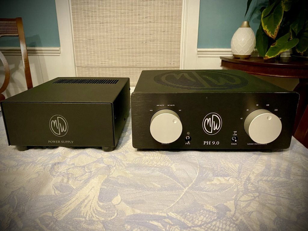

In the house. Packed meticulously. Rock solid Construction, Art and Engineering at it's finest. Or as Modwright puts it… Elegance, Simplicity, Truth……Can't wait to hook it up :D Thanks Dan!

modwright
  • Industry Contributor
  • Posts: 2655
    • ModWright Instruments
Re: New Phono stage: PH 9.0 MM/MC with on-the-fly loading!
« Reply #146 on: 4 Jan 2022, 05:27 pm »
Thank you so much for that!
The PH 9.0X does embody all that ModWright stands for! It is purpose built for the best possible sound and value. It is our best selling product!
Enjoy!
Dan
