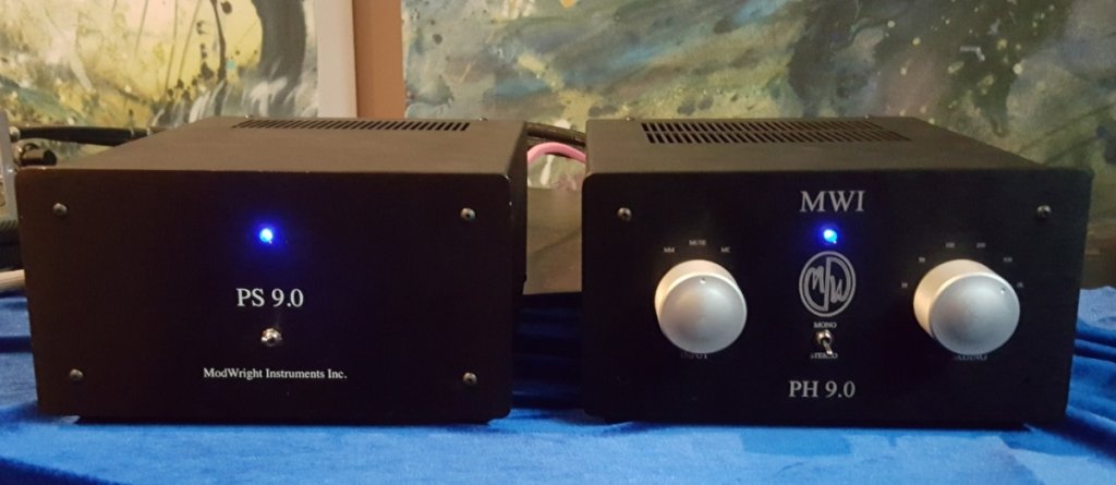

Photo of Proto/Concept PH 9.0 Tube Phono Stage, MM/MC 48dB/68dB. Price TBD (<$3K)
At Axpona Chicago (April 13-15), the PH 9.0 can be seen and heard in Room 604 with Studio Electric, ModWright and Zu Audio.
Features include MM and MC inputs, on-the-fly resistive loading for MC (MM = fixed 47K load), mono/Stereo and mute. Gain is currently set at 48dB MM and 68dB MC.  I may also offer a -6dB/-12dB attenuator switch to allow greater flexibility for different MM/MC cartridges.
I am also seriously considering as an add-cost option, transformer coupled XLR outputs for fully balanced drive. I have not determined the add cost for this option yet.
Some have also asked about a MM gain version only, to be used with separate step-up transformer.  I am also taking this into consideration.  This would be a lesser cost option of course, but I have not set a price.
This is merely a concept/proto.  It was built as a two box design, but I am considering making it a one-box design with aesthetics similar to our SWL 9.0 Anniversary Edition preamp.
Feedback and input about all of the above is certainly welcome.

Hey Dan,
I really like the one box look if you can make it sound about a good as the one with separate power supply.  It also saves space of my rack, which would be a problem otherwise.
How quiet is this or how quiet do you think it ill be?
Could use another MW product to go with my awesome MW 5400 you made for me.
Bob

Hi Bob, I am confident that if I lay things out properly, transformer orientation, shielding, separation, etc., it will be as quiet as the PH 150. Most importantly, the family sonic resemblance to the PH 150 ($7900 Reference Phono) is QUITE obvious in this < $3K design!
As it is made in the two box design, when put side by side, it is noisy.  Separate the two boxes by 12" or more and it is quiet.  However, and again this has to do with transformer orientation, when I put the two boxes face to face, close, there is VERY little noise at all!  So, I am confident that with the correct orientation, shielding and layout, the one box design will be just as quiet as the two box when separated.
It is for the reason of space and ease of installation in this regard that I believe the one box solution to be ideal.
Dan

Thank you all.  I have already pretty much decided to go with two boxes.  I believe the phono enclosure will also be of a smaller width at least, i.e. not full 17" wide, but closer to 1/2 width plus.
I agree about the flexibility idea and will be sure that there is good flexibility with regards to gain and the use of step-ups.
Last night at Axpona Chicago (show), we had finished setup and were listening to records through the PH 9.0. Dave Macpherson (Studio Electric speakers) and I played all kinds of records from a Reggae album that he engineered to some great jazz and 80's rock. It was thoroughly enjoyable to just relax and enjoy the music!
The PH 9.0 is very quiet! It is being used here with a Fern and Roby TT and the cart I need to ask about.  I think it is a Hana(?).  I need to ask the guys who mounted it on their table, because it REALLY sings!
In this case, because of lack of space, we literally put the supply on the floor behind the setup. I like this flexibility and have decided that the supply will be as basic as possible (in terms of the enclosure) and will house the transformer, choke and only the most basic parts of the power supply.  The regulation circuitry, etc. can all reside in the phono box.
I am very happy with this product and excited to release it! I have to have the chassis made of course and there are some final R&D details, but I will be putting together a Beta Tester list and the first units will be sent to the Beta team for feedback.

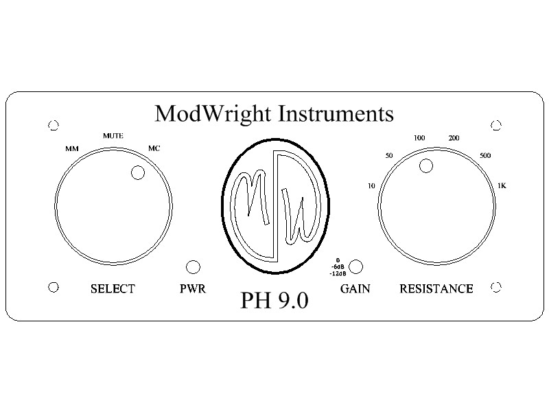

Design updates for PH 9.0 Phono Supply with external supply:
Projected retail price is still TBD, but will be < $3K for base model.
Chassis: Two box with external supply to be located away from the phono enclosure on a 5ft. umbilical. Main enclosure to be 8"-10" x 12"-14"D x 3"-4"H.
Step Up Transformers: Lundahl step-ups will be used for MC gain.
Gain: 50dB MM; 66dB MC (Gain adjustment: 0, -6dB, -12dB via toggle).
Functions: Mute, MM/MC, Mono/Stereo, MC loading (6-positions on-the-fly), Gain adjust (3 levels of attenuation).
Inputs: (1) RCA pair MM, (1) RCA pair MC, switchable on-the-fly.
Outputs: (1) pair RCA main outs; Optional pair transformer coupled XLR outs (add cost option).
Tube complement: (2)6C45, (2)6922.
Measurements:
Noise = -90dB MM, -76dB MC (unweighted)
Frequency Response: 20Hz - 50Khz (+/-.2dB)
In the end, the final design is very close to that of our Reference PH 150 ($7900). Enclosures are smaller and simplified. Some exotic parts are excluded and some aspects of the control and circuit design have been simplified. Sonically, the family resemblance is VERY STRONG!
Upgrade options anticipated (add cost):
Transformer coupled XLR fully balanced outputs.
Upgraded Umbilical.
Potential for power supply upgrades.
I will be finalizing and order the enclosures next and will be putting together our Beta tester list.  If you are interested in the new PH 9.0, please contact us right away!
Thank you,
Dan Wright
President, ModWright Instruments Inc.

Yes, the design is final and I am just working out the final chassis design now. Looks like the enclosure may be 10"W to accommodate the larger knobs used on the PH 150.
Finalizing PCBs now based on final circuit.
Lundahl step-ups are in and final gain is: 50dB MM (max); 66dB MC (max); Atttenuation toggle: 0, -6dB, -12dB. So MM ranges from 38dB-50dB and MC from 54dB-66dB.
PWR and Gain are mini toggles. Stereo/Mono toggle will be on rear of phono.
As you can see, the functionality (and schematic) are actually very similar to the PH 150! Gain is a bit less and some aspects of the design have been simplified by necessity, but the sound is remarkably close!
Increasing enclosure width to 10" allows for the use of larger knobs and better looking scale overall. It also allows for optional fully balanced, transformer coupled XLR outs (add cost option).
Thoughts and feedback welcome!
Dan
