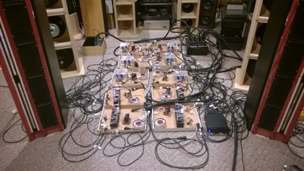

The wiring of the tweeter arrays to the amps is completed and reworked with the dspMusik RevD as the digital crossover.  Once the bass towers are moved, will be time to power up the system for measurements and Room EQ correction trials.
HAL
Re: The Megaliths open baffle line array speakers
« Reply #184 on: 28 Feb 2017, 09:08 pm »
At 11AM this morning, Avoosl made it over today to help me move the Super-V's upstairs for their demo in March.
What he did not know was that The Megaliths Stage 2 were fully operational in the listening room awaiting a demo.  After moving the Super-V's, we went down for the demo for the first time with everything operational with the system I have.
Sounds pretty good to me, but still a way to go with Room EQ and the 16 channel dspMusik as the next steps.  Earlier I had tried multiple music genres classical, pop and hard rock with equally good results.
The picture shows the PI Audio Group BlunderBUSS with the custom Triode Wire Lab HAL 2m power cables that were built for this speaker project.  My thanks go out to both of them.
It's alive.   IT'S ALIVE!   BWAHA BWAHAHAHAHAHAHAHA   :D
