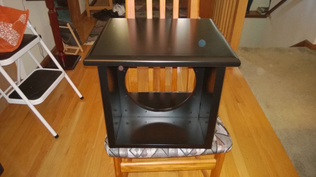

First modular 1x12 finished in Hot Rod black and I like it!!!  :D
Next week will start the other 5 modules for finishing to do one 6x12 at a time.

Tyson,
Thanks!
Guess I should have cleaned my phone camera lens.  The smudges are only in the picture.
This is about to be the coolest thing I ever built.

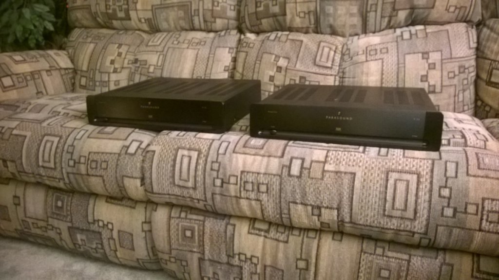

Two more black Parasound A23 amps unboxed and ready to connect to The Megaliths.  Matches the color of the subs and Neo10's.
Using silver Parasound A23 amps for the GT Audio Works ribbons.
Four more to go and all 10 of the amps will be installed and then testing begins.
