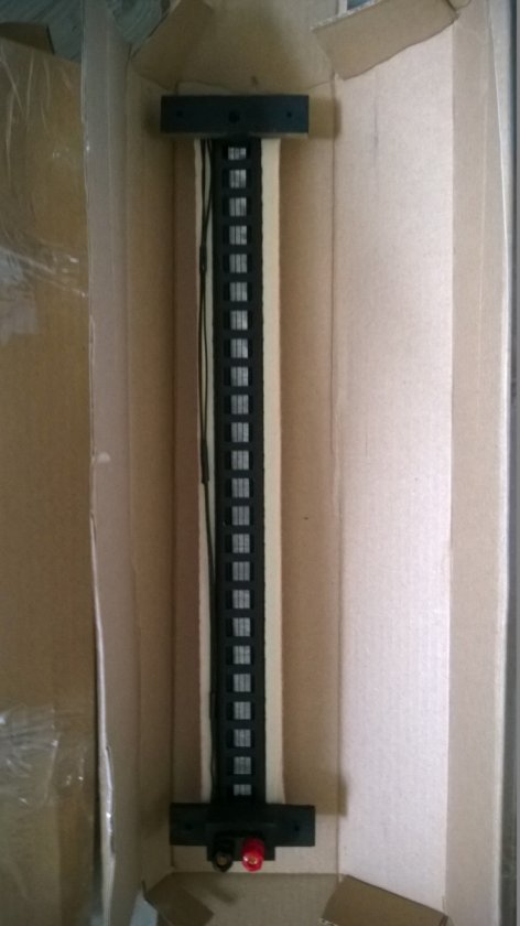

Unpacked the ribbon tweeters and did a test fit.  Have 1/2" on either side of the tweeter to take up to get it to fit, since the slot was sized for the BG Neo3.
The height is correct for one tweeter to match the length for 2 - BG Neo10's, so that will work correctly for stacking them.
Easiest thing would be filler so I do not have to drill new holes in the top and bottom header to move the one 1"x2"x87" oak strip.  The tweeter screws will match the existing width. Back to Lowes I go to look.
A very open mesh grill material for around the tweeters is here as well and I can possibly wrap that and the tweeter with the extra width material to hold it together before screwing down the arrays.

Test fitted a pair of ribbon tweeters using felt to hold them in the wood slot.  Works very well with the material I had, so now need to get more to complete the 8 tweeter install.  Then put in the 4 wood screws per tweeter to hold them in place.

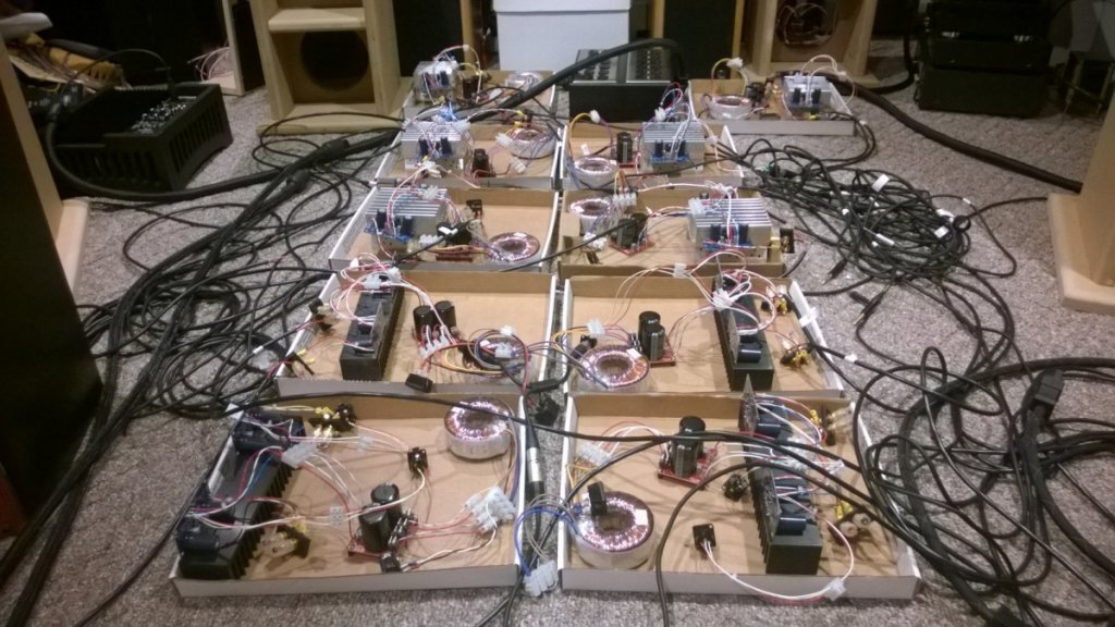

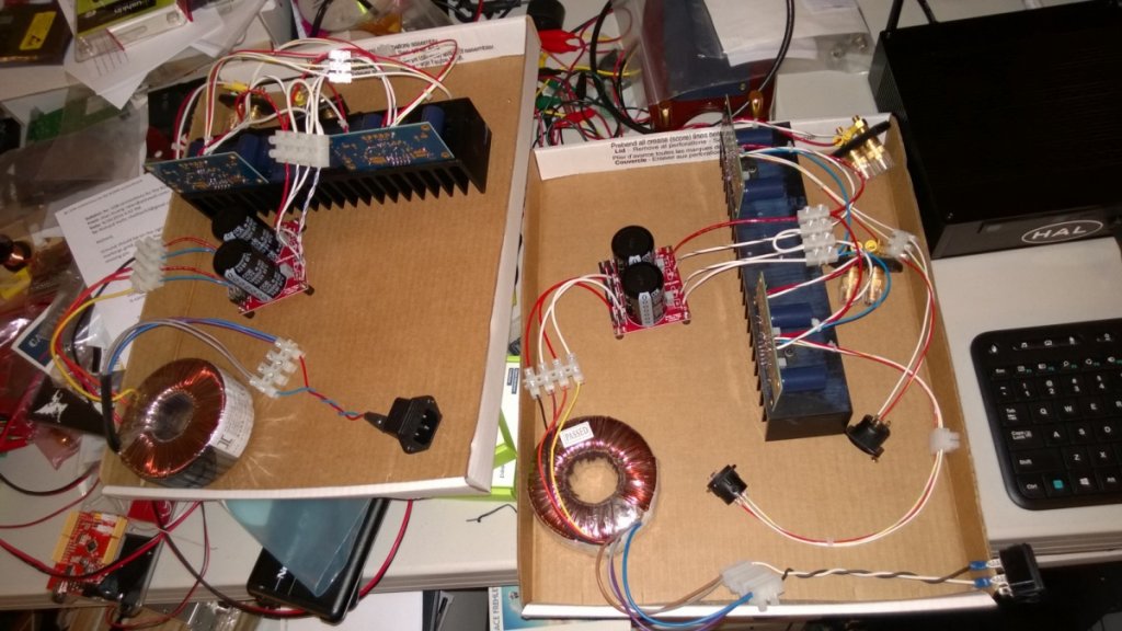

In the mean time the 4 amp modules to drive the tweeter arrays are complete and testing begins with the correct loads to simulate the ribbon and passive crossover needed until I get the 16 channel dspMusik system.  Using the 8 channel version now and reusing the midrange outputs with an extra high pass cap for the ribbons.

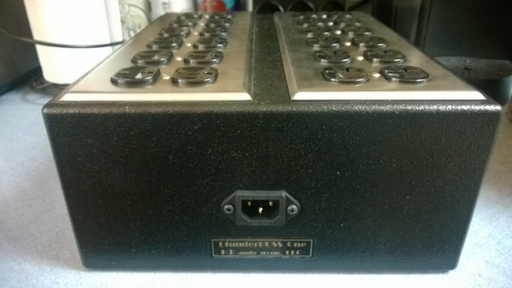

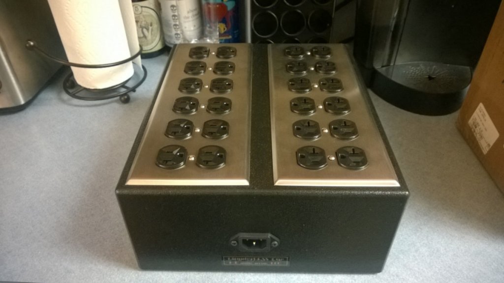

The PI Audio Group BlunderBUSS has arrived to power the amplifier array for The Megaliths.  The TWL HAL AC power cables are here as well for all AC connections.
This will have 20 Class AB amp channels, two Rythmik Audio HX800 servo amps and the dspMusik RevD connected for the drive system for the speakers.

Ed,
Figured it would be pretty big with 24 outlets.
To go with that, here are the 20 amp channels to drive the Neo10's and ribbon tweeter arrays and one of the Rythmik HX800 servo amps with the BlunderBUSS for power conditioning.

Getting the felt installed on the 20" ribbon tweeters for installation.  This will hold it in the slot to allow hole drilling and attachment.
I asked Greg for the 5-way binding post install to allow speaker cable attachment for each tweeter.  I had the binding posts from previous ideas.

The new tweeters were to long for the original slot.
Working on new headers to make the slot longer.  Since I do not do woodworking, have a friend helping.  Prototype worked, so now time to correct the original header widths.  Hopefully after the holidays will be reworked.

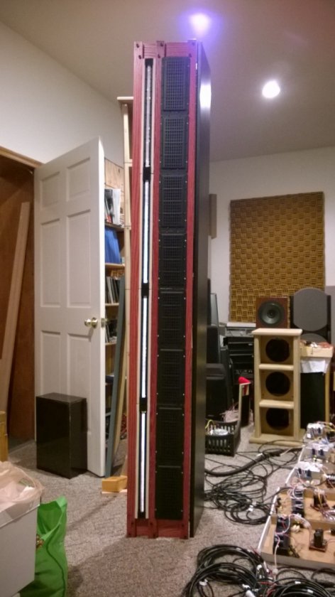

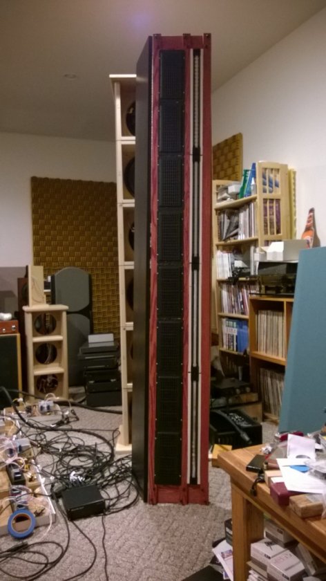

Re: The Megaliths open baffle line array speakers
« Reply #178 on: 24 Jan 2017, 01:52 am »
After some baffle rework, have the 4 ribbon tweeter arrays installed in The Megalith baffles.
The second phase will be a trial with the dspMusik with 8 channels, where the final phase will include the 16 channel dspMusik.
Will see how the new wiring goes to the tweeter amps.
