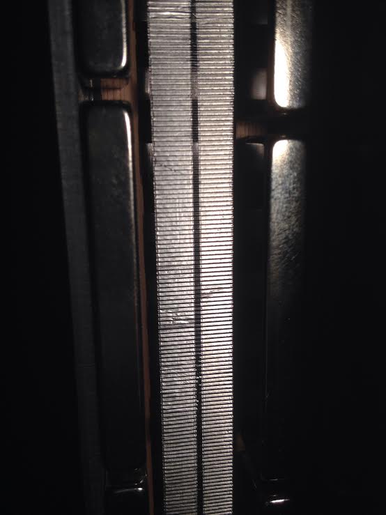

HAL
Facilitator
Posts: 5586
Re: The Megaliths open baffle line array speakers
Reply #153 on:
18 Aug 2016, 05:02 pm »
Here is a picture from GT Audio Works of the prototype dipole ribbon tweeter line array.
Greg had said he would not mind making them for folks interested. They can just contact him through his website.
KLH007
Posts: 462
Reply #154 on:
18 Aug 2016, 06:51 pm »
Greg's ribbon tweeters in my GTA 2.5s are only 48" long, puny in comparison, but they sure make cymbal crashes sound real and alive. I know Rich can't wait, and Greg is making them as fast as possible, soon Rich, soon. LOL
