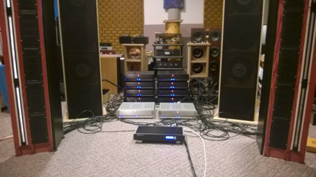

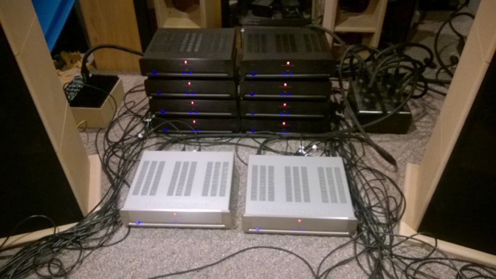

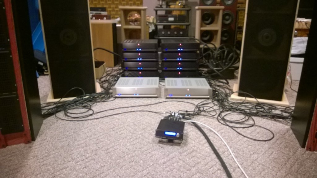

After 2 days of work with my friend Avoosl, the 10 Parasound A23 amps are installed and making great music. There is no strain ever on any volume level for replay. The system is not even done and it sounds really good!
Here are some first pictures of the system after removing the ChipAmps and installing the A23's.
Thanks go to Avoosl and Richard Schram at Parasound who have helped greatly to get this speaker system to the next stage of existence.
If anyone does not believe DSP crossovers can sound better than a great passive version, they should hear these speakers. That can be arranged!

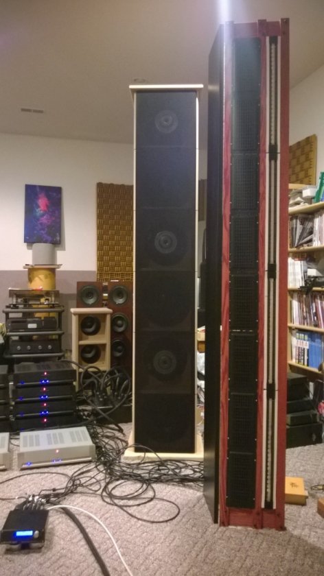

The Megaliths 16 channel dspMusikLCD crossover design is ready for testing.  The system arrives next Sunday for measurements and listening trials to begin.
The excitement builds!!!

The 16 channel dspMusikLCD with the first revision The Megaliths crossover is up and running!
Need to make more measurements and try the room correction with Foobar2000 with the new crossover.
This is getting better all the time!!! :)

It is a 7 way array speaker design.  :o
